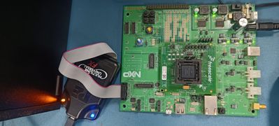

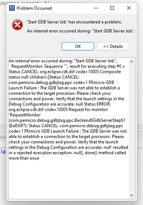

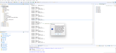

     We are tried to flash or debug the Example application MPC574XG - MB & MPC574XG - 256DS board in S32DS Power Architecture IDE, we encounter an error Device not detected or censored(Picture attached below).
     After clicking Debug option we observed D1, DS1 LED's were blinking immediately we were getting the above mentioned warning.
Pop-ups after above warning:
How to proceed further or any other settings needs to be adapt in IDE? Also attached our board image as below. Is there any jumpers settings needs to be modified for this problem?

First I would like to ask you whether you have ever had this board running or it is the first attempt to connect to the device?
Here you may check how to connect with Multilink and S32DS:
http://www.pemicro.com/blog/index.cfm?post_id=180
Maybe you may find an answer there.
