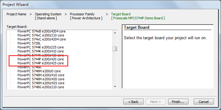

I am developing a 5744P program in Greenhills, but I don't know which one to choose.
My board is Development board for MPC5744P, and the details can be found in this link:Development Board for MPC5744P|NXP
When I new a project using Greenhills, I found there have 3 options about 5744P
I want to know which one I should choose and what is the difference between these three?

Hi, e200z425 is the core used with MPC5744P.
e200z420 was use on old revision. Production device use e200z425.
