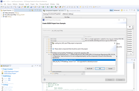

I used the " MPC5744P REV_E Kit " and RTM3.0.0 , the SDK_S32_PA_11 included the FS65 component lib (SBC) inside. However , i updated S32DS_PA than this FS65 component lib was removed from SDK_S32_PA_11. Now, when I open this RTM3.0.3 example FS65 component lib that required to install the " SDK_S32_PA_15 " .
Can you please help me to know where or how to download this " SDK_S32_PA_15 " and installing into S32DS_PA.

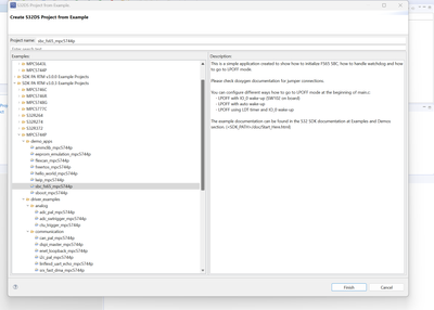

Is is part of 3.0.3 installation package.
You simply select PA_15 and the project will be created.
Peter

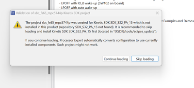

Krishnayya29
Hi Rehab hassan,
Could you please tell me how can i resolve this issue because i am also not able to see
SDK_S32_PA_15 version .
Krishnayya

Tod
Hello Peter
I get it and find this PA15
Thank you and have a nice day
