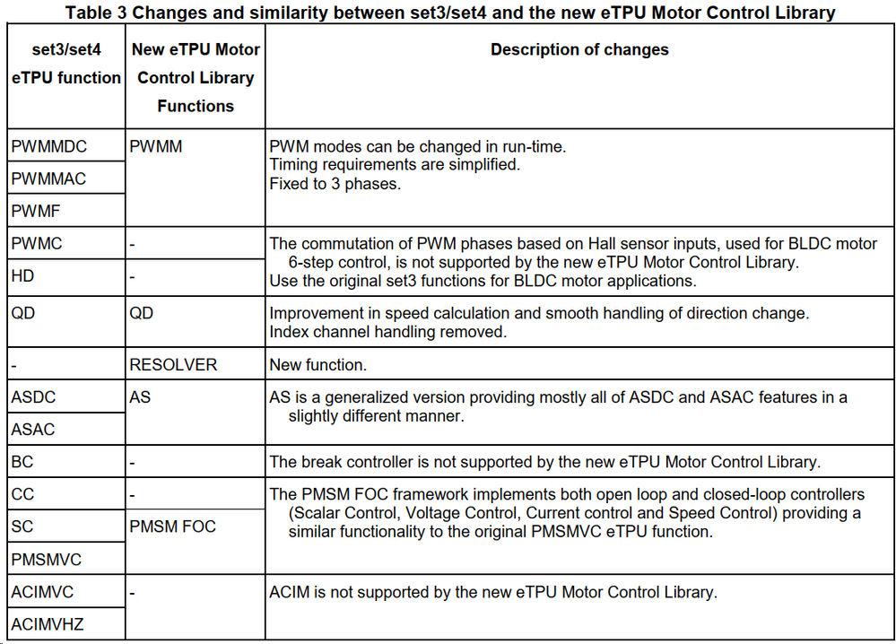

davidtosenovjan
There is no officially launched document. Preliminary appnote regarding Motor Control eTPU Library exists, I have already taken a screenshot above, consist some description of all functions, maybe some of them are described only partially as the document is still preliminary.
Please create new case according the procedure below with reference to this thread and I will send the document to you. I have just been agreed with authors.

davidtosenovjan
I am attaching screenshot from preliminary appnote regarding Motor Control eTPU Library, also with descriptive text.
"The set3 and set4 eTPU functions enabled to create a closed-loop motor drive on the eTPU, running independently of the host CPU. It demonstrated the power of the eTPU to completely handle the control of all types of motors (DC, BLDC, PMSM and ACIM). The MPC55xx host application just commanded the required speed or torque and monitored the eTPU operation. The ASDC and ASAC eTPU functions also interfaced the eQADC via eDMA which in turn enabled to handle analog signals, DC-bus voltage and phase currents.
The primary goal of the new eTPU library is not to implement the simplest form of a closed-loop motor drive on the eTPU. The eTPU or eTPU2 on MPC56xx and MPC57xx is more powerful, can run on higher frequencies and can serve more advanced customer needs. The goal of the new eTPU functions is to serve as full-featured motor control peripheral modules and also to enable the customers to implement their own closed-loop control within a prepared framework.
The new functions are created using a new coding style, which is MISRA compliant, easy to read, reuse or modify. Assembly code, if any, is isolated in library routines."
