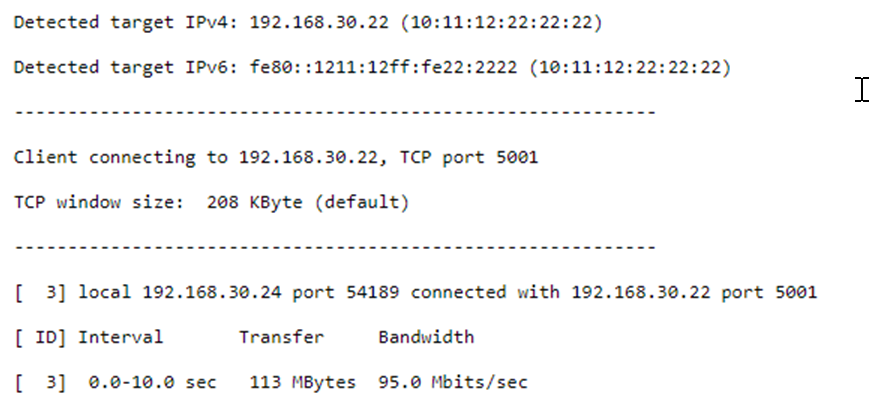

lukaszadrapa
I got information that benchmark test was done on LWIP demo which is available in SDK. Iperf version 2.x (client) from website iperf.fr was used.
This command was used: iperf.exe -c 192.168.0.200
... where 192.168.0.200 is address of board.
Here is the result:

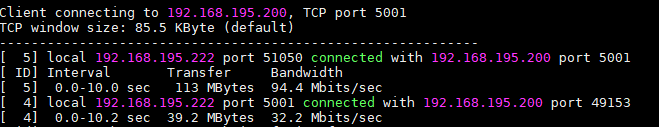

gj3526
hi,
 The iperf can test tx and rx,I use iperf.exe -c 192.168.195.200 -r,the tx only can reach 30Mbps.
the result:    (LWIP demo)

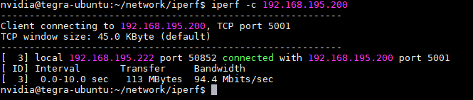

gj3526
HI,
   I tested my job use Iperf,the network speed can reach almost 100Mbps.but now I need use mpc5748G to send large amount of data.Is there a demo for test TX?
the result in my test:
