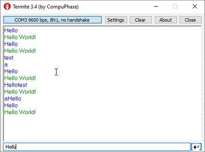

My, question is where should I type "Hello" to get "Hello World!"?

this example is written in the way it waits for message received from console. If the message contains "Hello" in first 5 characters and it is received within 300ms , the "Hello World!" is send back. The application does not echo if received bytes are different.
So ideally use some terminal that can send whole message after you trigger it, for example mentioned Termite
BR, Petr

You must first install a terminal, for example "Termite", and configure it according to the UART configuration of the program. (In principle the basic configuration of the Ternimal is that of the program).
debug the program by leaving the Terminal window open.
The "Hello!" is indeed written on the Termite Terminal console.

I want to type another word say "Hello" again on hyper terminal, and program in not going inside IF loop.
Please suggest me how to do it.
BR, Petr
