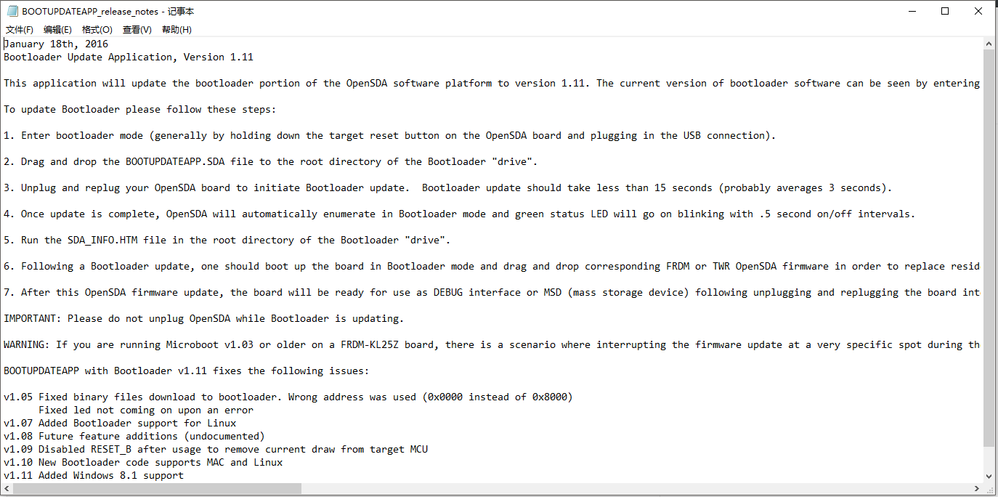

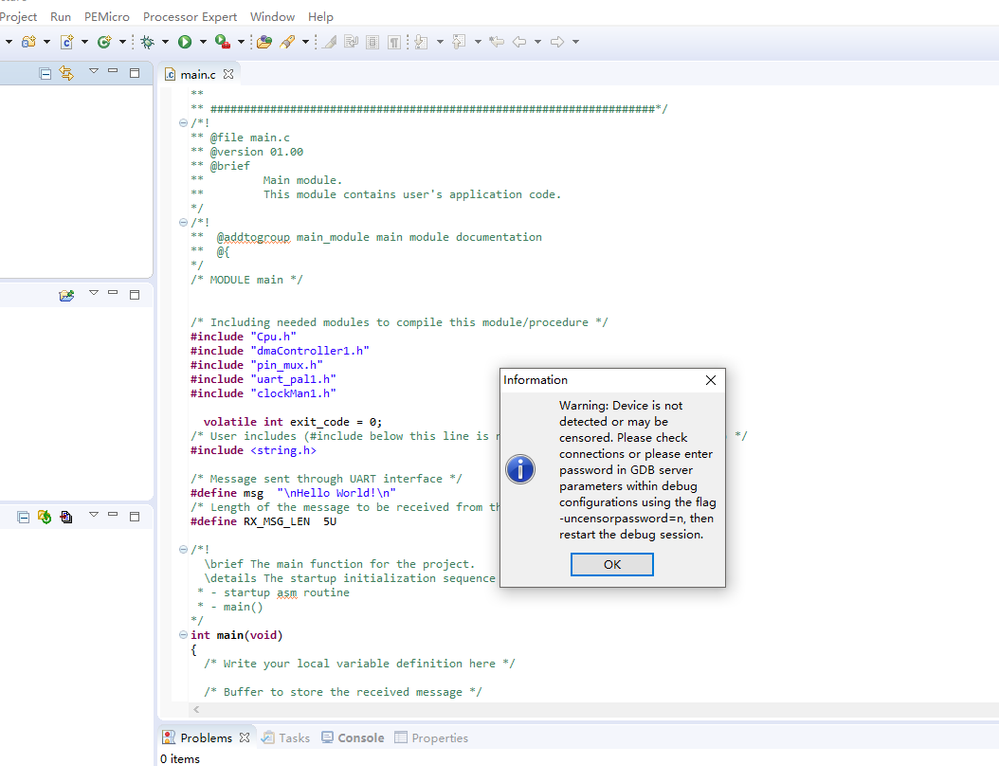

I get a new NXP MPC5748g development board, then I follow the intruction and quick start to set the bootloader. But the the device does not work. These are the steps which I followed. When I reach the fourth step, the light does not blink. And the S32DS can not detect my device. How to solve it ?

once you have updated BOOTUPDATEAPP_Pemicro_v111.SDA, it's necessary to enter bootloader mode again and load DEBUG-OPENSDA-E200_Pemicro_v110.SDA.
There's no bootloder for MPC5748G, so to be able to debug the board in S32DS, it's necessary to load the debug application for e200 cores (not bootloader).

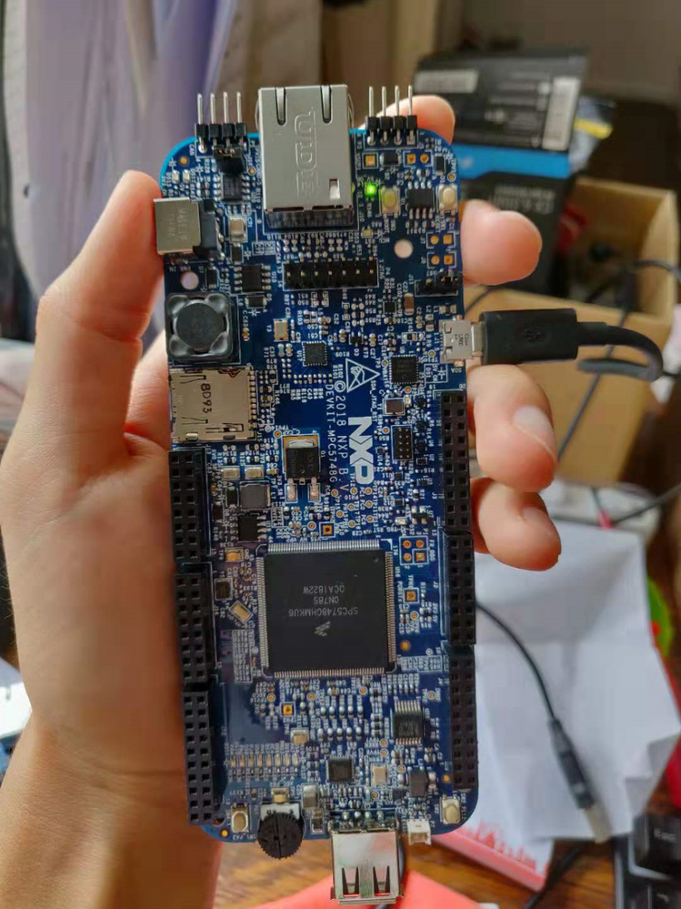

I just follow your tips to update BOOTUPDATEAPP_Pemicro_v111.SDA and DEBUG-OPENSDA-E200_Pemicro_v110.SDA, then my board looks like that and the S32DS still can not detect it. I wonder if I should do something in the S32DS or there is something wrong during my update operation?  Thanks.

if you want to supply the board via USB cable only, it's necessary to reconfigure jumper J11:
This should help, I hope.

Hi Lukas,
Thanks a lot, it works.
