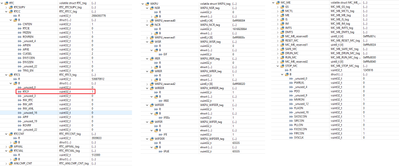

I am having trouble with this.
I am trying to run example in the Cookbook (AN2865 - Qorivva Simple Cookbook.pdf), plus the example in this post.
In this example, I see that it looks like it is trying to transition to Stop mode, which is what mine is doing.
In this example, It doesn't actually go into stop mode. You can see in the register that the current mode is RUN0.
I don't quite understand that part. It should run the line while(MC_ME.GS.B.S_CURRENT_MODE != 0xA); ,then stop at while (MC_ME.GS.B.S_CURRENT_MODE != 0x7A) because it would be in STOP_MODE.
I just don't understand why it is not working. The RTC part works. I have tested that.
All the registers appear to be correct. (See below)
The RTC event flag is set (RTC.RTCS.RTCF = 1). I configured Stop mode. I am entering Stop Mode from RUN3 mode, but it just sits at transition mode. Never goes into Stop Mode, nor does it recover from stop mode.
Thank you
