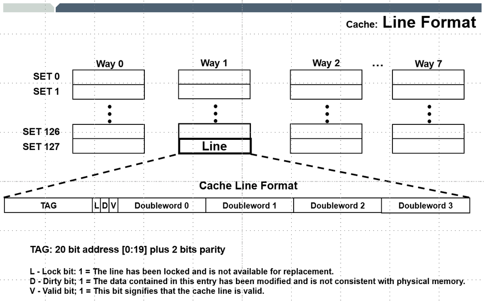

1. 11.2 16 KB cache organization (P584 ~ P585 in e200z759CRM.pdf)
- What are the correct length of TAG, Lock bits, Dirty bits and Valid bit of cache line format ?
  : TAG - Physical Address Tag (22bit) + Parity (?)
    Lock bits(?)
    Dirty bits (?)
    Valid bit (?)

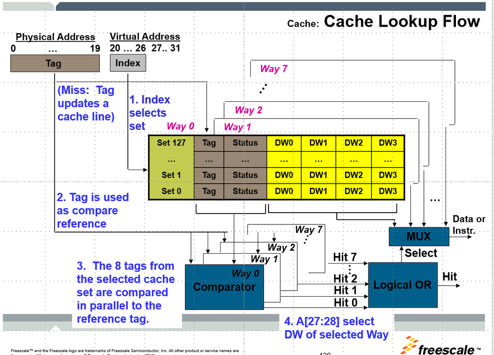

2. 11.3 Cache lookup (P585 ~ P587 in e200z759CRM.pdf)
- What are the length of the TAG REFERENCE and the OFFSET ?
  My understanding is that the length of TAG is 20. (32bit Address = 20 bits for tag + 7 bits for set(line) + 5 bits for word offset)
  But, in the document, the length of TAG is 22. It's duplicated A[20,21] of physical address and virtual address. Is it correct?
  Almost of documents for cache describes that address size is equal to the sum of tag, index(set) and offset.

1) It should be like this:
2) It'll be rather 2 bits of parity.
3) No, it just points to the way. Index to cache set (line number) is determined by several bits of virtual address => every address has only one possible set to be stored, but it can be in 4 possible ways.
See the picture in the middle of this article, it just shows cache to target memory mapping:
https://community.nxp.com/servlet/JiveServlet/downloadImage/
2-946843-194949/pastedImage_1.png
==> It's OK if valid bit and lock bit are 1 bit.
But, I'm still confused because of the below article that is in e200z760RM
document of NXP.
9.8.5 EDC Checkbit/Syndrome Coding Scheme Generation—Icache ( at
e200z760RM.pdf)
Each tag entry utilizes six check bits to cover the tag + valid bit, and
each double word of data in the data arrays utilizes eight check bits.
The lock bits utilize bit-level redundancy, thus are independently
protected.
Where can I find the six check bits to cover the tag + valid bit ?
Are there no redundant bits for lock?
If lock bit is just 1, how to support EDC/parity check for lock bit?
2-946843-194950/pastedImage_2.png
<https://community.nxp.com/servlet/JiveServlet/showImage/2-946843-194950/pastedImage_2.png>
==> I think it's related to the answer of the first question.
http://alasir.com/articles/cache_principles/cache_line_tag_index.html
==> A set has 4 ways.
If all of ways in a set are locked, how to find a way to fill?
Can the replacement pointer point to a way of the next set?
