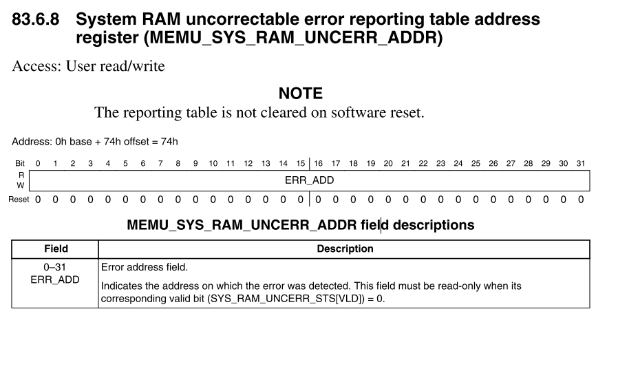

What is the significant of the the address in the SYS_RAM_UNCERR_ADDR, especially when it is an adddress in Flash memory?

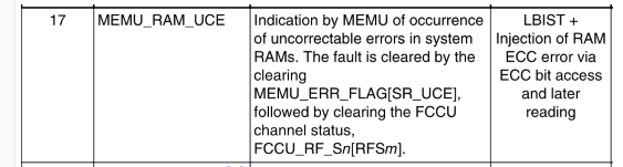

When this happen, I see that I got the channel 17 of FCCU asserted (MPC5777M). I would note that this does not happen frequently, we saw it may be after a few hours of running software, or not see at at all.

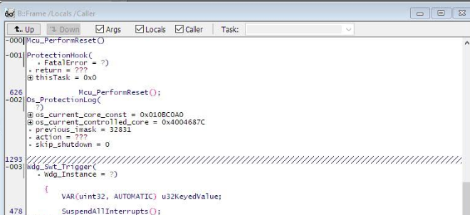

I attach the stack frame of our software where the issue is catched. You can see that our OS rise the Protection log, right after the line 478 of the Wdg_Swt_Trigger, where it is access to the above variable. That seems to me that the MEMU have reported the "relevant" error, but I have no idea how that happens.

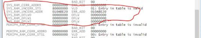

Upon further diagnosis of this issue, I would like to update with the following. When this issue sequence begins, it always begins by main core 1 throwing IVOR1 (machine check exception), and this is followed by either main core 0 or the IOP throwing IVOR6 (program exception) followed immediately by IVOR1. When IVOR6 is thrown on the other core, it is immediately followed by IVOR1 without executing a single instruction of IVOR6, according to the Lauterbach trace. Because main core 1 is the core that always starts the sequence, we've centered our investigation on this core first, which has yielded the following discoveries, which overlap what @truongtran1 reported. We see the following:
  • MCAR is set to the flash address where the NXP MCAL WDG data structure is stored to access the SWT registers based on the accessing core.
  • MCSR has the LD, MAV, and BUS_DRERR bits set, which matches the fact that a load instruction was being executed from the flash address reported in MCAR.
  • Curiously, MEMU reports the error as a System RAM Uncorrectable Error, with a flash address stored in the System RAM Uncorrectable Error register.
  • We see no signs of crossbar errors during this time (or at all) using the XBIC module.
   The curious thing for us, which is previously pointed out by @truongtran1 , is the fact that a flash address is being written to the System RAM Uncorrectable Error portion of MEMU. I've attached a core register dump of main core 1 to show the IVOR1 related data, and I can confirm the same result previously reported by @truongtran1 , regarding the SYS_RAM_UNCERR_STS and SYS_RAM_UNCERR_ADDR containing a flash address (in our case, the same flash address specified by MCAR).
