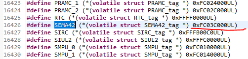

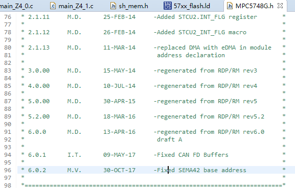

SEMA42 base address has been fixed to 0xFC03C000ul in "MPC5748G.h".

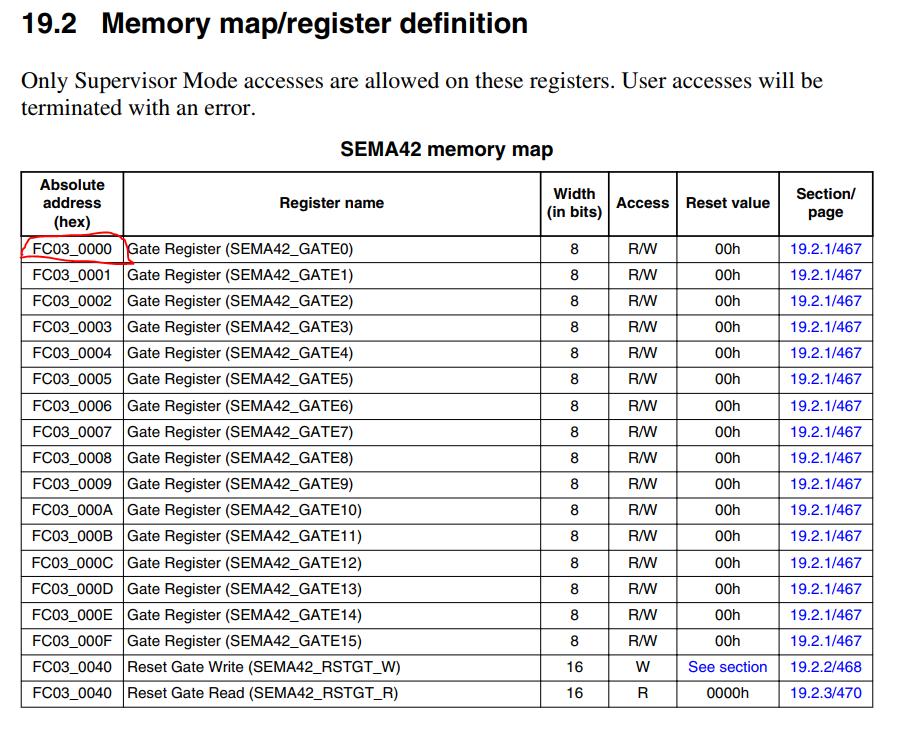

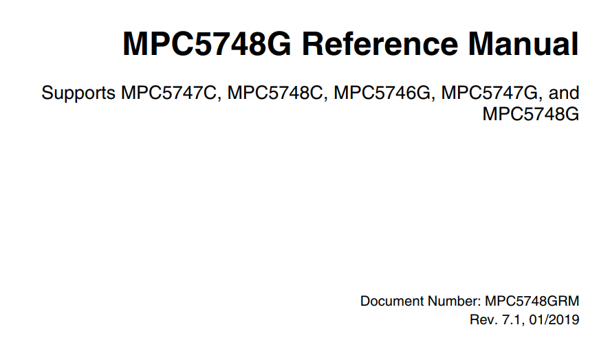

But in the newest reference manul, it's still 0xFC030000UL.

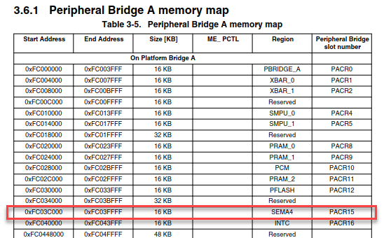

this will be RM error for this table, as memory map shows right value

Yes, I noticed that. Hope you can fix it soon because the whole chapter used this wrong address. Thanks!
