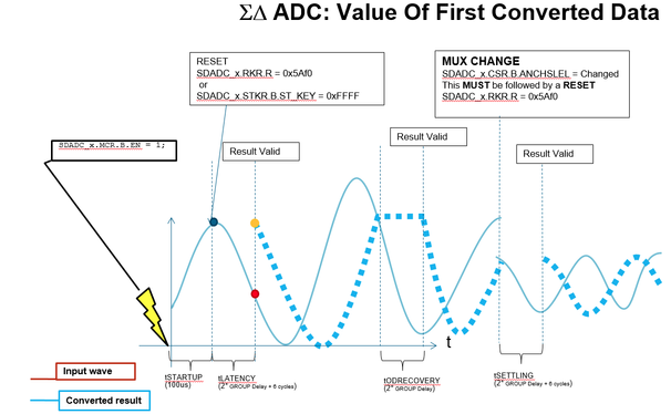

hi i am using SDADC in MPC5777c. when i am using single channel i am getting the result in SDADC_CDR register.i want to use multiplexed channels and want to store the result in some array.how to access the converted result which is stored in FIFO structure?
1,155 Views
davidtosenovjan
First of all I would note that SDADC module is not too suitable if you need to convert to perform fast switching between channels because of t_settling time between every switch. On the device there is also eQADC module present that is much better for this purpose. SDADC is well equipped for frequency-domain digital AC signal processing type applications where continuous conversion of one channel is needed(knock, cylinder pressure).
You may switch channels but need to count with the latency.
