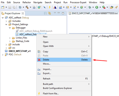

Problem 2:how to delete files?
I delete the TestFolder file ,then click "project"->"clean",no useful,corresponding file is still under the Debug file.
Could you help me? Project attached.

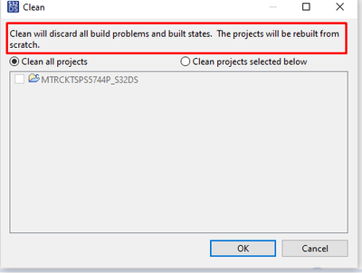

petervlna
I had check description on clean.
So the files are deleted, but then project files are rebuild imediatelly.
Peter

fanziyu
Thanks for your help! But i don't understand what you mean.
Could you see the "DeletePicture1" picture? I delete the TestFolder in my project,but after i used the clean function, the TestFolder is till in debug folder(output files).

petervlna
I mean, once you use clear function, the project generated files will be regenerated.
This is usually used in case there are major changes in project and you need to regenerate it from scratch.
Peter

fanziyu
Thanks!
My colleague do the same thing in S32DS for arm,the TestFolder will not be still in debug file after use clean function.I'll try it myself later.

petervlna
Simply follow the guide:
Therefore every subfolder that contains header files must be added to
the list of include paths. Go to project properties. In the properties window, go to C/C++ Build>Settings>Settings>Standard
S32DS C Compiler>Includes>Include paths. The directories specified in the Include Paths window are the locations that the
linker searches when the #include macro is implemented.
This will clean your generated files, like objects, binaries, etc...
Simply do as follow:
Peter

fanziyu
I use clean function,but the generated files are still there.Is that a bug in the IDE?
S32 Design Studio for ARM Version 2018.R1
For some reason,I must use the Version 2018.Is there a solution?
