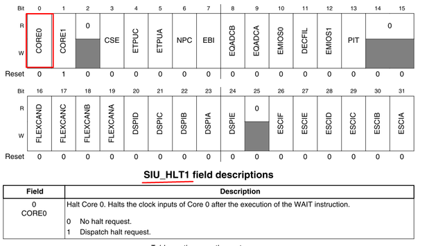

In the reference manual:
So you have to execute wait instruction on the core0.
Then you will ask for halt reques in SIU_HLT1

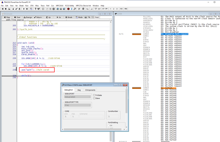

You can see I have executed wait from core1, then I ahve switched to core2 and asked for halt of the clocks from debugger:
After that core0 is halted.
Peter

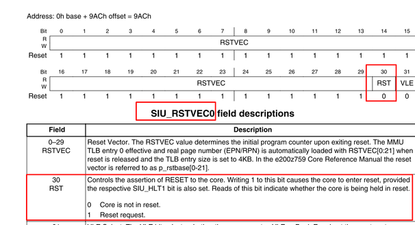

You will boot on core0 by default. Once you have all initialization done and core 1 active.
You simply put core0 clocks in halt
and then put core0 into reset:
Peter
