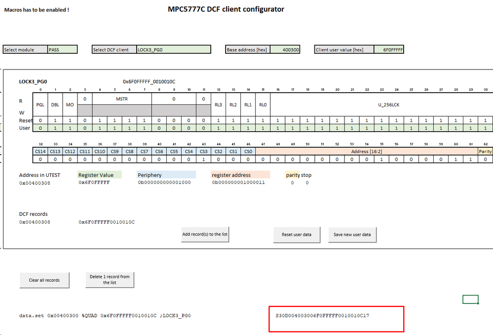

To make it simpler we have created DCF calculators which also provides s-record format for PE:
Calculators are here:
MPC5777C DCF Configurator

if offline tests need to be performed i think as per my understanding i cant use the DFF record and cmm script file used /genarated using lauterbach  as provided in the examples. Im using s32 design studio how to use/create DCF records and run the tests in offline mode. Pl do suggest .
You can program DCF records from application or use other debugger than Lauterbach. (for example PE)
