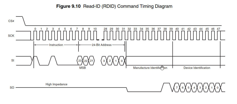

   Im reffering the MPC5676R example for developing similar SPI interface with flash with that of MPC5777c .I have a clarification regarding some commands requiring chip select low and execute and make it high after it.
Where in this example is t executed ? is it in the PUSH and Push ENQ where the CONT bit is set and EOQ bit is set.
 the code snippet where its required is given below,
and if that is the case ALLOW Transfer is used for what. could u pl explain.
The below example is reffered.
https://community.nxp.com/docs/DOC-335461

Hi, I would like to note it is only example code, not an official driver.
macro PUSH sends data, letting CS line asserted
macro PUSH_ENQ sends data, negating CS line, also it set End of Queue flag (it pauses command execution)
macro 'ALLOW Transfer' clears End of Queue flag allowing command execution previously paused by PUSH_ENQ.
This way you may compose every SPI memory command per bytes with using of several PUSH and one PUSH_ENQ macros.
Example SPI memory command below:
    ALLOW_TRANSFER; // if previous command has set EOQ
    PUSH(READ_ID);  // read data bytes command
    WAIT_UNTIL_RxFIFO_IS_NOT_EMPTY;
    POP(dummy_var); // discard one RxFIFO item
    PUSH(0x00); // most-significant byte of address
    PUSH(0x00); // middle byte of address
    PUSH(0x00); // least-significant byte of address
    PUSH(dummy_byte); // dummy byte for generating CLK to slave
    POP(manufacturer_ID); // read useful data
    PUSH_ENQ(dummy_byte); // dummy byte for generating CLK to slave
    POP(device_ID); // read useful data
