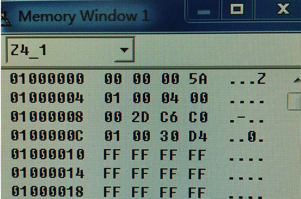

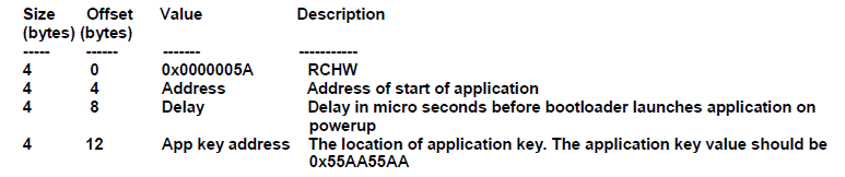

   The APP code’s boot header information is shown in the figure below,which is according to <<Version 1.6.7.35 Release Notes>>. The APP can run with MPC5746R_20MHz.rbf ,so the APP code will be certainly right.

I believe you have the RCHW at the wrong location. It should instead be located in the range of 0x00FA0000 - 0x00FA3FFF. Please see the attached updated documentation.

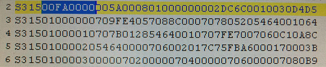

1) The value of RCHW for MPC57xx is 0x005A0000 not 0x0000005A ->Therefore the BL won’t found the second app. See below:
2) The RCHW address must be located within 0x00FA0000 - 0x00FA3FFF not from 0x1000000. See below:

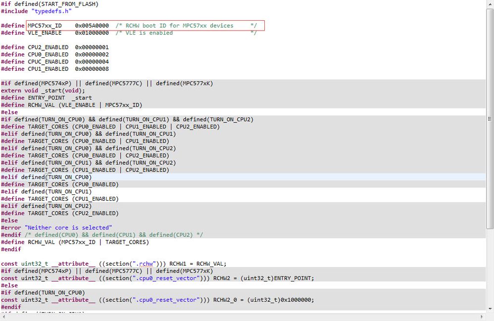

I suggest some configurations as below:
For flashrchw.c:
const volatile uint32_t APPKEY __attribute__ ((section(".appkey"))) = 0x55AA55AA;
const uint32_t __attribute__ ((section(".rchw"))) RCHW [] = {
                                                RCHW_VAL,
       /* cpu0_reset_vector */ (uint32_t)_start,
       /* delay */                       0x0000000,
       /* application key */   (uint32_t)&APPKEY

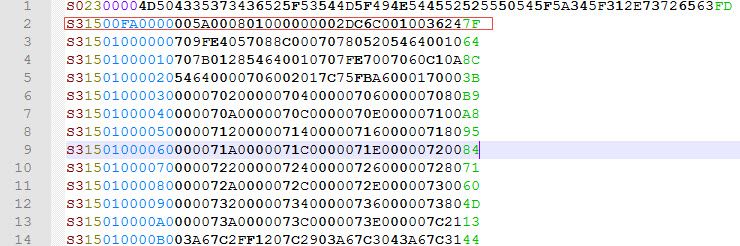

 I corrected the  boot header information of my APP , and the RAppID BL can work well . After downloading, the APP can run immediately.
The  boot header information like this:

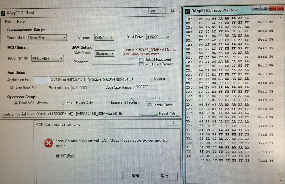

2.  The read function doesn't work. See below,after uploading 3%, RAppID BL stops and then the timeout is reported.

2) On the C55FMC flash memory, the blocks used by your application are not consecutive so when RAppID BL is reading your application, it will to read some unauthorized access area. In this case, the BL will stop reading process and return an out of range message but RappID BL does not show this message.
To read memory for your application, please as workaround do the following(refer to attached images for detail):
+ Read RCHW area: startAddress: 0xFA0000 with size < 0x4000 (16K for this block)
+ Read m_text area: startAddress: 0x1000000 with size < 0x0380000 (all of 256k block)
Hope it helps!
