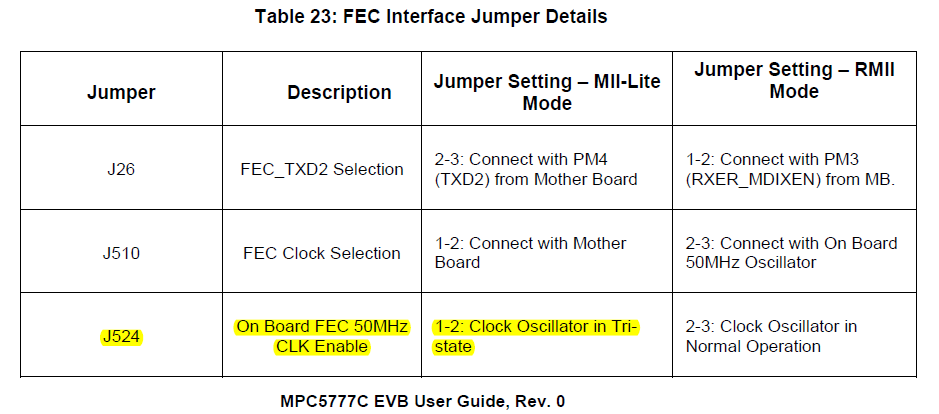

  - According to 'MPC5777C_EVB_USER_GUIDE' document, on Board FEC 50MHz CLK is enable with J524 jumper setting.

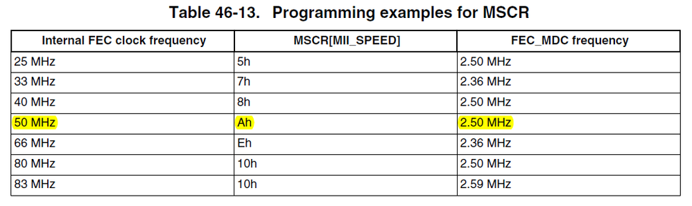

  - With that jumper setting, if I set the 'MII Speed Control Register(FEC_MSCR)' with '0xA', it results in an 'FEC_MDC frequency 2.5MHz. Is that right?

The Jumper Configuration
J24 is 1-2.
J510 is 1-2.
J514 is 2-3.
The function isConnected is return TRUE when the cable is Connected.

  2. The MDC frequency is calculated from the internal bus clock, in this case it should be PER_CLK selected by SIU_SYSDIV.PERDIV

//Peripheral Clock Setting, 50MHz / 2 => 25 MHz(Internal bus clock)
SIU.SYSDIV.R = SIU_SYSDIV_PERCLKSEL_NON_FM_CLOCK | SIU_SYSDIV_PERDIV_DIVIDE_BY_2;
FEC.MSCR.B.MII_SPEED = 0x5;       // 25MHz x  (1 / ( 5 x 2 )) = 2.5MHz
