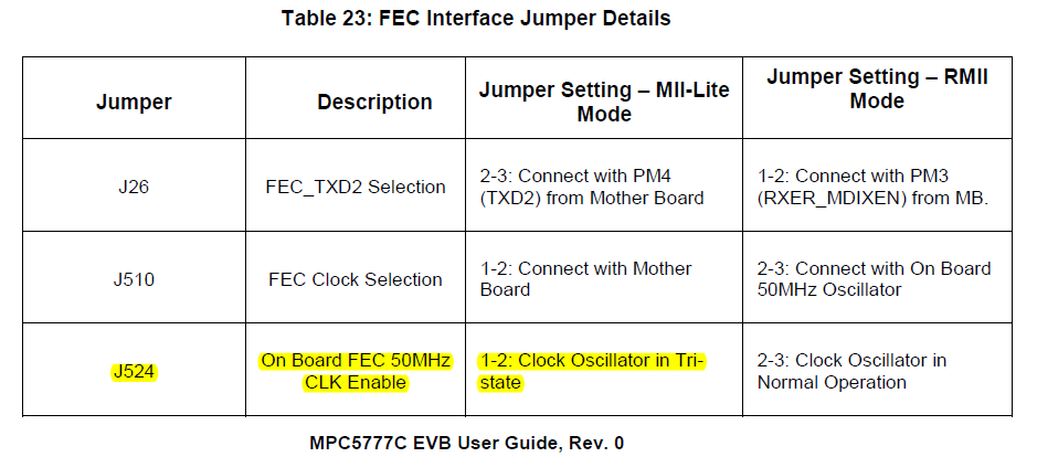

  - According to 'MPC5777C_EVB_USER_GUIDE' document, on Board FEC 50MHz CLK is enable with J524 jumper setting.
  - With that jumper setting, if I set the 'MII Speed Control Register(FEC_MSCR)' with '0xA', it results in an 'FEC_MDC frequency 2.5MHz. Is that right?

I am using a MPC57xx MB Rev C,
The Jumper Configuration
J24 is 1-2.
J510 is 1-2.
J514 is 2-3.
The function isConnected is return TRUE when the cable is Connected.
Is it possible with a wrong clock configuration ?
I used the same clock configuration as the example Example_MPC5777C-PinToggleStationery.

Note: on Rev.A of the EVB minimodules the RXD2 and RXD3 are not directly connected to the PHY. Also there is no 50MHZ oscillator, which is needed for RMII mode. This is fixed on mini-modules of rev.B or higher.
