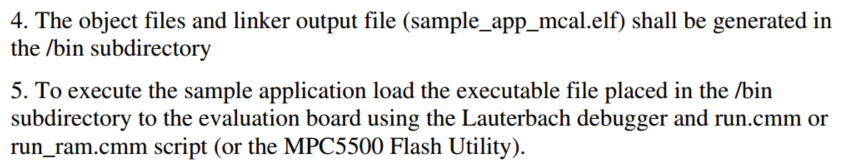

   I am studying MPC5746R MCAL sample application. According to the document :
But I do not have Lauterbach.  Can I load the *elf file  to my target using GreenHills or S32 Studio? How should I do that?

petervlna
Its good to make clear some facts:
1. Compiler - Greenhills, S32DS, Windriver, etc...
2. Debugger - Lauterbach, iSystem, PEMicro,Greenhills probe, etc...
To load elf file you need a debugger which you connect to microcontroller. If you don't have Lauterbach you can use any other debugger to lead *elf file.
Peter

qiaodeng
Hi Peter,
    The debugger I use is PEMicro.  I mean is it possible to use S32 Studio or GreenHills to do the work   what  Trace32 does(import the *elf then download it to my target)
Qiao

stanish
Hi Qiao,
you can use S32 Design Studio to program your .elf into the device since MPC5746R is supported.
See some info e.g. here:https://community.nxp.com/docs/DOC-332252

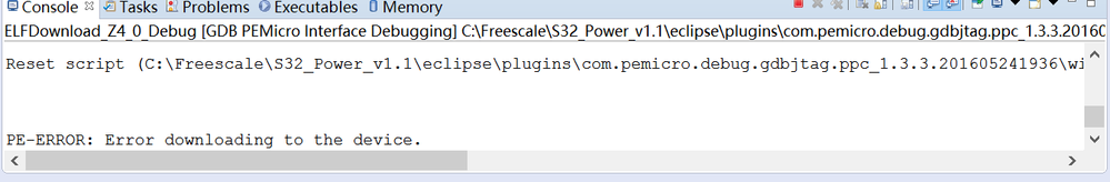

qiaodeng
Hi Stan,
     I've followed the instruction to download the .elf  and encountered this error:
How could I handle this?
