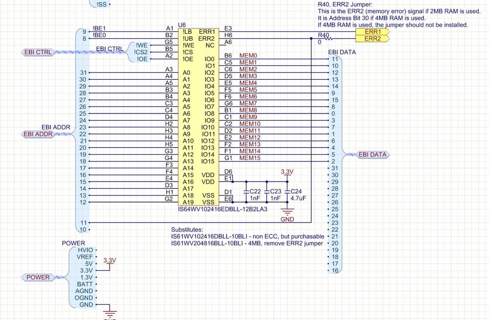

Electrical Engineer connecting mpc5777m EBI to a RAM chip. I am curious if I have connected the memory address lines correctly.
The mpc5777m EBI is connected to an SRAM BGA with 1024x 16 bit words and 19 address pins. I added a 20th address pin in case I use the 2048x 16 bit word version of that chip.
PowerPC is opposite endian, so I think that means address bit 31 from the processor is connected to address 0 of the RAM. PPC Address bit 12 is RAM bit 19. PPC bit 11 would be RAM address bit 20.
Then there are Byte enables. PPC 'address bit' 9 would be lower byte enable. PPC addr bit 8 would be upper byte enable.
Is my logic correct? Here are images of my wiring:

If  APS=1, then can external address line A31  be connected to A0 pin of external flash or SRAM(16bit data bus)? Is the connection right?

Hi, please take a look at following document, especially section 3, 4, 6:
https://community.nxp.com/docs/DOC-101725
I believe it answers your question.

Does the "address by port size" bit (EBI_OR[APS]) allow the address lines for a 16 bit data port memory to start at 31 instead of 30?
2,907 次查看
davidtosenovjan
Theoretically yes, but I know an erratum exists for MPC5777C device:
If you are in design stage I would rather recommend to connect it usual way.
2,907 次查看
jschloss
We decided to try it, looks like APS=1 is working for us on the MPC5777M, so we are able to use the address line that would otherwise be unusable due to byte select muxing.

If  APS=1, then can external address line A31  be connected to A0 pin of external flash or SRAM(16bit data bus)? Is the connection right?  what is the result of your trying?
