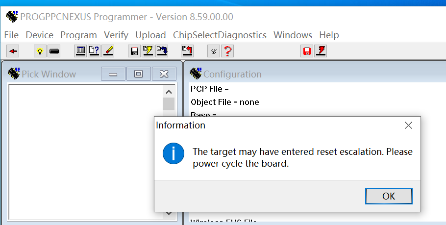

The mpc5748g-lcevb development board I purchased is powered on after connecting to progppcnexus. After clicking connect, the following interface appears. The target may have entered reset escalation. Please power cycle the board.
Power on repeatedly according to the following prompts, and the phenomenon is still.
What is the problem? How to solve it?

The reason will be probably due to feature newly introduced with MPC57xx devices - it is called 'Functional' Reset Escalation and 'Destructive' Reset Escalation (MC_RGM_FRET and MC_RGM_DRET) and it causes that after predefined number of functional reset, destructive reset happen and after predefined number of destructive resets, device will stay in reset until next POR.
The solution is to stop the core just after power-on-reset, attach by debugger and erase MCU/reload the code.
With TRACE32 it can be done by “Halt core at power-on reset” feature (Select in the menu: MPC5XXX - Tools - Halt core at power-on reset.).
If you have only PeMicro debugger available, I have found another thread describing how to attach with PeMicro:
https://community.nxp.com/thread/504643
Also check whether you have properly attached power to the board (DEVKITs and similar boards may have jumpers for selecting power from USB or 5V barrel connector) and sometimes you may see such warning when MCU is just unpowered because of 5V power supply is not attached.
