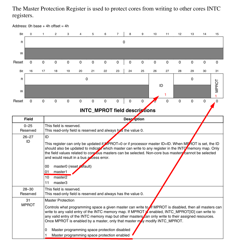

(a) What is master ID? is it different from coreId?  Is it configurable by the user?
Master ID => is the logical bus master assignments
As I do not know which device you are using I can only show below the screenshot of MPC5746R reference manual.
(b ) what does "corresponding processor" mean in the above description?
Means only processor which ID corresponds to INTC_MPROT access settings.
(c) In S32DS, how can I configure MPROT and MPROT_ID using Processor Expert?
I am not familiar with PExpert. Someone else should answer you quesiton.
(d) For my application, i want to use Software interrupt SS5_IRQn to interrupt core1 from core0. Only core0 should be able to set the interrupt and only core 1 should be able to clear the interrupt. How should the register be configured?
1) Program INTC_PSR5 for core0 interrupt execution only.
This is done by default from reset settings
2) Program INTC Master Protection Register (INTC_MPROT) according to your needspastedImage_23.png
