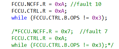

The FCCU configuration remains unchanged. I make a fault injection of NCF[10] for example but a reset can also be observed. There should be no reset cause no reaction is set for NCF[10]. Why do I always get a reset, no matter which fault is injected, although no reaction has been set for this fault?
Here is my configuration:
and code for fault injection:
Thank you in advance for help!

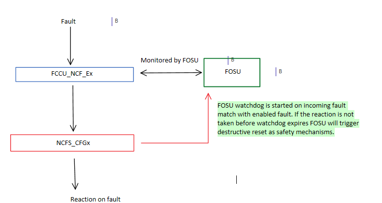

petervlna
Because your reset on NCF[10] is coming from FOSU and it is a destructive reset.
Not FCCU itself.
FOSU is enabled by setting any bit of NCF_E and correspondingly same bit in any of the NMI_EN, IRQ_ALARM_EN, EOUT_SIG_EN or NCFS_CFG.
Peter

yixinwu
Thank you for the quick reply.
I have read the chapter 69.7 in the user manual. The mechanism of FOSU means, no matter which reaction for which error is configurated, FOSU will trigger a reset for any fault in FCCU because the 'do nothing' input from FCCU is not asserted? And this FOSU seems not to be disabled?
If I just want to get an alarm for a fault, I should stop the FOSU internal timer by doing following from FCCU according to user manual:
1.Reset: Long or short functional reset
2.IRQ: NMI or Alarm
3.Error out triggered (by FCCU or by SW)
The first one is clear and it is the option which I don't want. The second means the register of FCCU_NMI_EN or FCCU_IRQ_ALARM_EN can be configurated. This has been tested and it works. What is the meaning of the third option?
