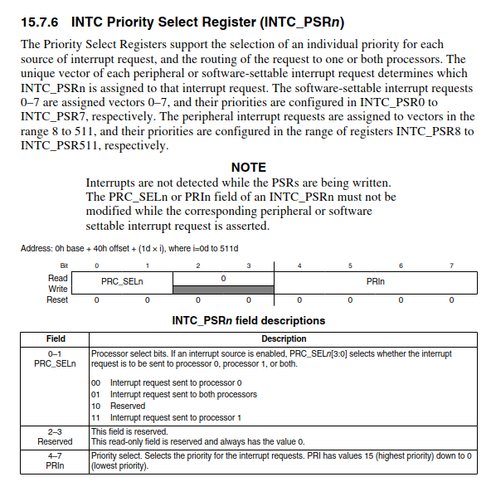

I am using MCP5777C MCU and I have a question about interrupt priorities. I could not find any tables showing default priorities settings when I have examined reference manuel.
Is there any source showing us which interrupts have which priority numbers as default?
Thanks in advance:))

Hi, by default, INTC priority is set to 0 for all INTC input sources.
