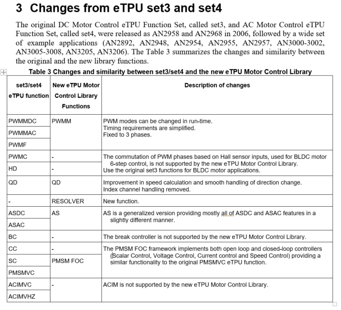

We are already offering these functions for CW here:
CodeWarrior eTPU Function Selector - NXP
you can use them directly or have a look at them to see the current implementation.
you can see the list below:
regards,
Peter
