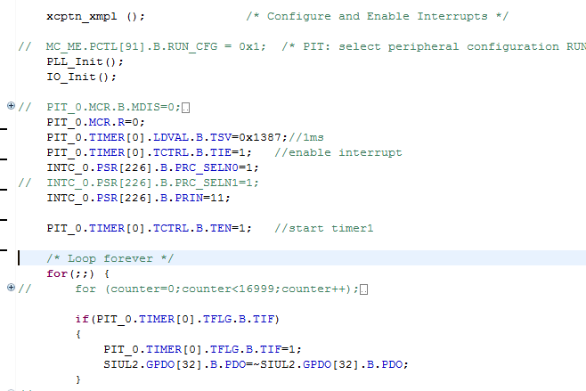

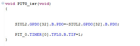

Hi All,
when I debug the PIT module, I enconter a problem: 'void PIT0_isr(void)' can be executed.
In order find the reason ,I read the  PIT_0.TIMER[0].TFLG.B.TIF , and the PIT_0.TIMER[0].TFLG.B.TIF has be set .
Then I add the code :
if(PIT_0.TIMER[0].TFLG.B.TIF)
PIT_0.TIMER[0].TFLG.B.TIF=1;
SIUL2.GPDO[32].B.PDO=~SIUL2.GPDO[32].B.PDO;
and I used the scope to read the Pin[32],and the result is also right : the timer period is exactly 1ms.
But Why the funciton 'void PIT0_isr(void)' can not be executed?
How can I solve this problem?
Thank you!
168486_168486.pngpastedImage_1.png168491_168491.pngpastedImage_3.png168487_168487.pngpastedImage_2.png

petervlna
Did you program ISR vector table according to your ISR?
Place the breakpoint on IVOR4 offset address and step trough your IVOR4 handler prolog to see if the code jumps to your desired ISR.
Peter

petervlna
Did you set correctly interrupt priority?
