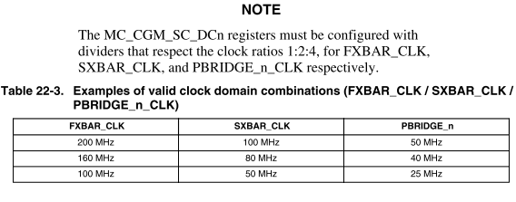

please look at the following table from reference manual.
This table shows, that PBRIDGE frequency has to be one quarter of system frequency (FXBAR_CLK).

umsteigen
Ok.
I only noticed the table 22-2 in the reference manual and ignored this table 22-3.
