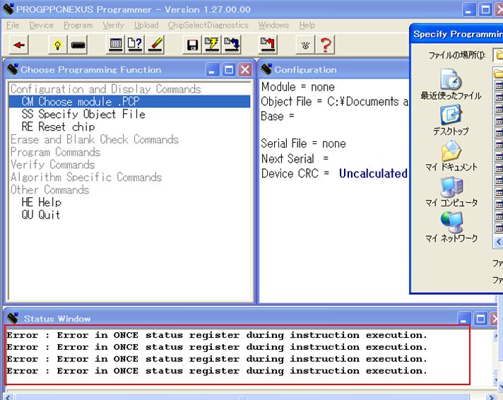

The device is MPC5565 and we can not use P&E tool to read or erase the ROM, and the P&E show the below error:
Error : Error in ONCE status register during instruction execution.
Could you kindly help to give me some advice about it?

1) Error in ONCE status means the communication between the P&E interface and the chip has been lost. This can be due to debug shift frequency being too fast, or a RESET has occurred, or bad signal due to bad hardware. First, please lower the debug shift frequency in connection manager.
2) Yes monitor TDO, TDI and TCK but I would also monitor RESET as well. If RESET is always toggling, that means there is a watchdog causing periodic resets.
3) Do you have any custom ribbon cables, adapters, or other unique hardware setup? This can cause delays in communication and slow fall/rise times so it is important to shield long ribbon cables and slow the debug shift frequency to have a stable communication.

Dear Yamada san,
Thank you for your kindly answer.
We have tried to lower the debug shif frequency as your advice, but the failure is all the same.
Then, we exchanged another same board to confirm, all is right. We exchanged the MPC5565 for the two boards.  And, the failure point at the  MPC5565 in the failure board.
I want to check more failure information for this case, but I don't know how the "Error" failure happen.
1,What is the wrong signals for P&E tool so that it will report the "Error" in the status window?
2,Is checking the waveform of the TDO, TDI, TCK helpful?
3,If you have other advice, pls also kindly tell me.
Thank you & Best regards!
Jehan Wang
