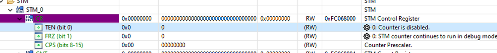

I encountered a problem when I can't get write access to many EmbSys registers.
Everything was good with GCC, but after switching to DIAB I get this problem even if I set a breakpoint at very beginning of the startup code.
After an attempt to write, S32 highlights such a register in purple (see attachment)Screenshot 2023-03-17 192046.png
Debug console gives no hint on that.
Tools data:  MPC5748G-DEVKIT rev D, diab 4.7.1, S32 v2.1
Could you advise a direction on where to dig for fixing this? What is the meaning of the purple color?

rchw sections for gcc/diab projects and debugger settings are identical

Please make sure the execution in debugger is halted when checking embsys register view (P&E cannot read the registers in while code is running). Also please double-click on peripheral register name to disable and re-enable the register to view again - the register value should reflect the latest value.
Also please make sure you enabled the peripheral clock to the peripherals you are writing into. Perhaps there is a diff between diab and gcc init code.
Hope it helps.
