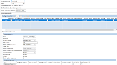

Then configured the flexCANC as below (it is the one connected on the NXP eval kit to SBC)
Init is done as below
FLEXCAN_DRV_Init(INST_CANCOM2, &canCom2_State, &canCom2_InitConfig0);

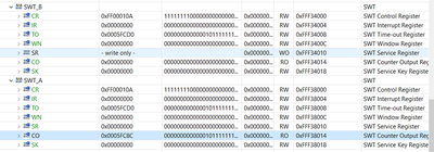

It was a connection issue now the send works, but reception has got a weird SWT1 exception.
Sending is now done every 384ms and Reception code is as below:
/* Configure RX message buffer with index RX_MSG_ID and RX_MAILBOX */
FLEXCAN_DRV_ConfigRxMb(INST_CANCOM2, RX_MAILBOX, &dataInfo, RX_MSG_ID);
FLEXCAN_DRV_Receive(INST_CANCOM2, RX_MAILBOX, &recvBuff);

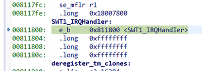

On receiving the msg the LED is toggled. I could toggle for few times but then I get the SWT1 exception.

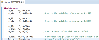

I could see both the SWTs are disabled. but getting this excpetion.
Below are the register value on hitting SWT1 exception.
Help is much appreciated!
