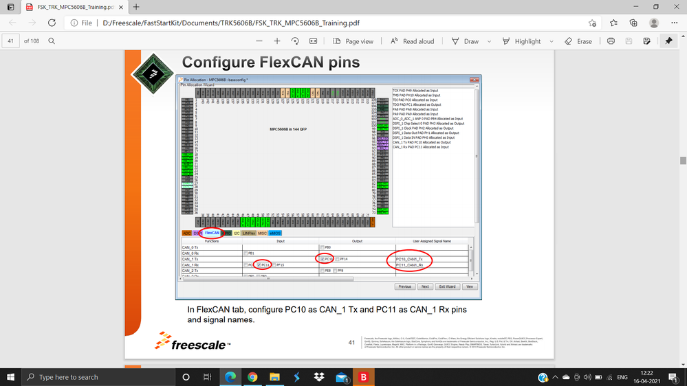

I have searched a lot in the web of how to initialize multiple CAN bus ports in MPC5606B startTRAK dev board. And here is how you do it,
Follow the steps as it is in FSK_TRK_MPC5606B_Training.pdf with one difference,
Initialize additional CAN bus ports using RAPPid init (i.e) Initialize CAN0,CAN1 by checking the boxes (both input & output) if you are in need of 2 CAN ports.Make all additional changes for these CAN ports as well as mentioned in the FSK_TRK_MPC5606B_Training.pdf document.
MPORTANT NOTE: CAN1 is connected to SBC transceiver by default, so I removed those PC10/PC11 jumpers and connected my external transceivers TJA1050 directly to those port pins!
This example is intended to get CAN message from port 1 and pass it to port 0 which automatically sends it to any external device!
Follow all the steps carefully as mentioned in the pdf!!
In step 1=>Select CAN0_TX(PB0)  & CAN0_RX(PB1) as well.
In step 2 , 3 , 4 follow the same as usual
In step 5 =>select CAN0 tab and do the same procedure mentioned for CAN1

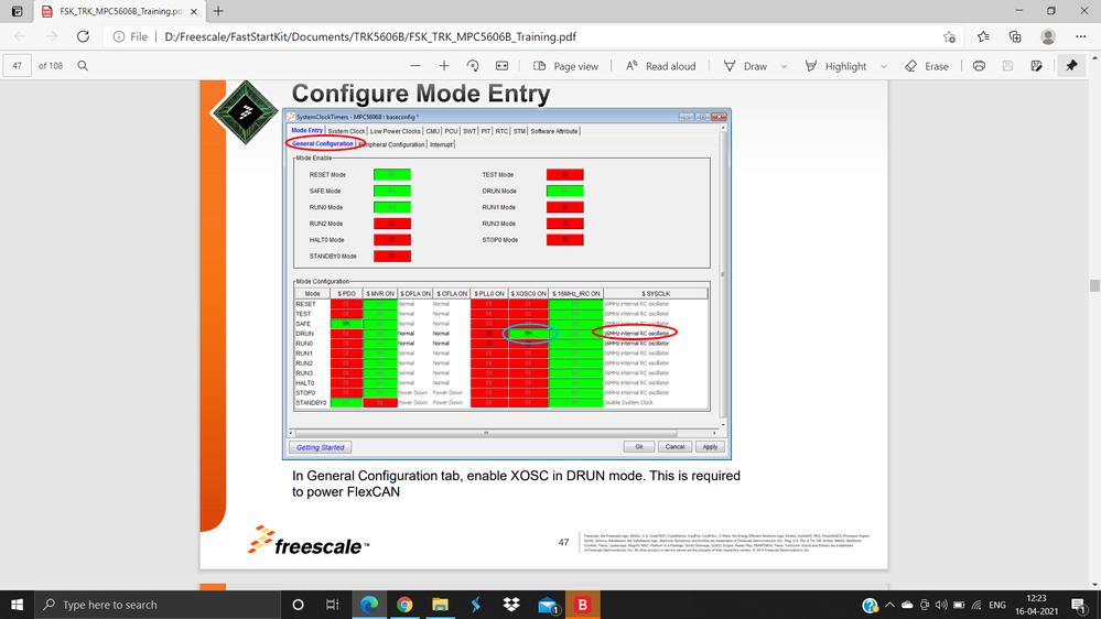

Then
1.Configure section map
2.Configure code generation
3.Generate code
4.Configure report generation
5.Generate Report
6.verify the report which is generated (Report.htm)
7.Use main.c provided below in the workspace
8.Run codewarrior project
9.Run cwpjmaker utility
10.Create codewarrior project
