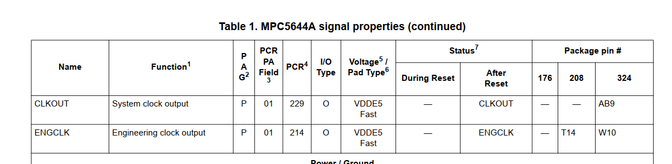

Hi all,
Is there any way to measure the frequency of the system clock in order to check is it correctly initialized or not?
I am currently using MPC5674F and MPC5642A development boards.
Mert KİREMİTCİ.
661 Views
davidtosenovjan
Externally you can measure CLKOUT or ENGCLK but you need to count with pre-dividers (SIU module).
