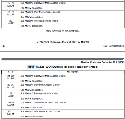

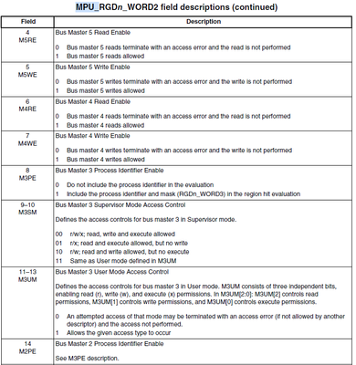

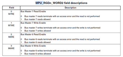

Hi, can anyone tell me, the each bus master correspond to what here:
PS: I'm using the MPU for the MPC5777C

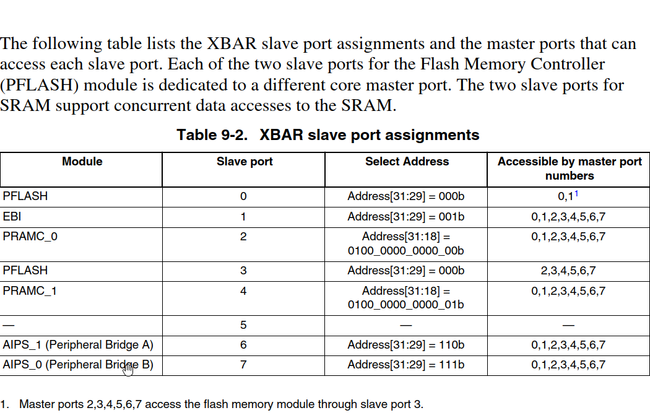

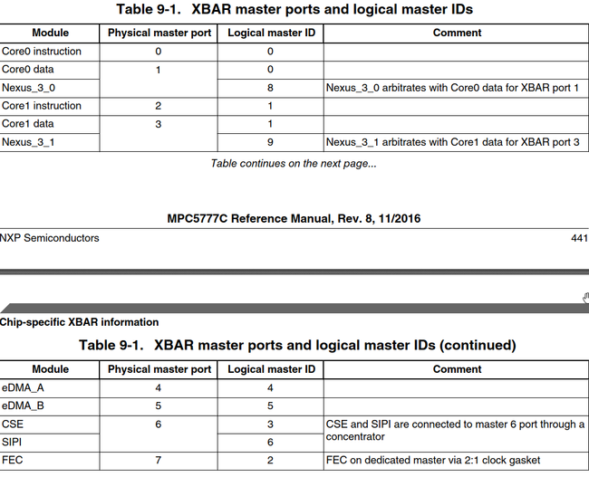

It is defined in XBAR chapter as port number are related to MPU as well.
1,015 Views
Othmane1
You mean it is this one right?
1,011 Views
davidtosenovjan
Yes, physical master port number.
