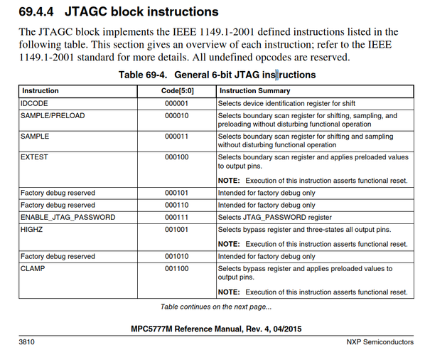

Hi, Where can I get more information about flash programming via JTAG for MPC57XX.  I know my device has a 6-bit instruction register, but the only doc I could find was AN4365 which is for 5-bit instruction register.  Are there details somewhere?
7 Replies
3,884 Views
davidtosenovjan
It is the same in principle, but register has more bits. There is not further appnote, but instructions should be described in the RM as example below:
