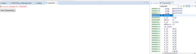

I am trying to debug example code from s32ds and when I try to debug, "No source available for 0x800400" pops up.
how can I get rid of this when I debug? 

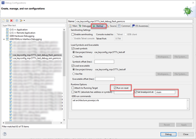

Regarding the "No source available..." message - it looks like the code just stops at entry point. Go to Debug Configurations and check if "Run on reset" option is checked:
