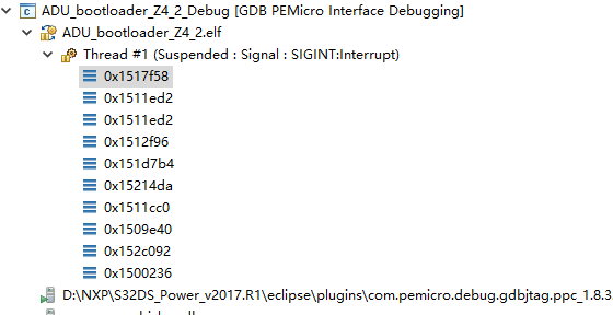

I make a bootloader for MPC5777M, which can recv hex file and upgrade code to flash.
But the bootloader can't jump to app.
#define APP_StartAddr (*(uint32_t*)0x00fc4004)
void Prepare_Before_Jump(void)
// flexcan_0_deinit_fnc(); /*shutdown the MSCAN module*/
uart_disableInterrupt();
systick_PIT_deinit();
PPCASM (" wrteei 0 "); /*disable the CPU interrupt*/
CleanRAM(); /*clean the bootloader used RAM for NVM driver*/
void app_entry(void)
Prepare_Before_Jump();
(*(void (*)(void))(APP_StartAddr))();   /*run the function via function pointer convert with a certain address*/
while(1);/*stop here for anyhow*/
I tried like this, but it doesn't work:
#define APP_StartAddr (*(uint32_t*)0x1500000)
asm("e_lis %r12,0x0150");
asm("e_or2i %r12,0x0000");
asm("mtlr %r12");
asm("se_blrl");
the bootloader link file:
the app code link file:
when i debug it, the debug info is as follow:

hi,
Did you solve this problem?  I used the same jump code as you,but only Z7 core can work normally,Z4 can`t work.
Are you from China? Hope to communicate with you for advice,my wechat --  shengkun1102.

lukaszadrapa
is address in this definition correct?
Could you double check? This should work if the address is correct. Try to step the asm code to see what happened, which address was loaded and where it jumped.
