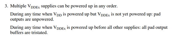

However, in the MPC5777C Microcontroller Data Sheet, we are not finding anything related to the VDD power up post other supplies requirement.
Also, there is similar question in the community (Solved: Re: MPC5777C - Power up sequence - NXP Community,) where problem solved by powering on all the supplies together instead of sequencing VDD later.
Please let us know, still do we need to consider the AN5268 old document guidelines, or we can ignore the power on sequence for MPC5777 and ramp up or down any order.

Which mode you are using?
Mentinoed sentence
"Power up VDDPMC/VDDPWR, VDDA_MISC, VDDA_EQ, and all VDDEx/VDDEHx supplies first and then power up VDD. "
is rather related to mode with externally supplied VDD. In case VDD is sourced by internal SMPS/LDO regulator, it is more or less out of user control.
Powering on all the supplies together is correct, there's no harm in that.
In the DS there is a specification related to VDD, indirectly telling VDD is supposed to be powered later.
