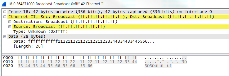

Hi.

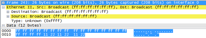

I have problem with transmission of Ethernet frame.
When I captured a transmitted Ethernet frame at the other monitoring system, it looked like the Ethernet frame data was disordered.
I have set the source MAC address like a 0x11, 0x22, 0x33, 0x44, 0x55, 0x66
The captured packet showed disordered MAC address and wrong data length.(I set the frame length '18')
I'm considering that this problem caused by miss configuration of FEC DMA or Transmit Buffer Descriptor.

taekyoungkim
I found the similar issue from FEC CodeWarrior MPC56xx - Tx repeting bytes
From that issue,
This is very hard to explain if you have 32-bit memory and the FEC is reading 32 bits at a time, as it would require some intermediate "byte-lane changing hardware" to be doing something stupid.
It would be easier to understand if you've got 16-bit RAM, or a 16-bit pathway between the FEC and the RAM. the "pathway" is unlikely as the FEC is a master on the Crossbar.
You can see that the transmitted Ethernet frame was duplicated 16 bit words.
ex) 11 22 11 22 11 22 11 22 11 22
Is this because Crossbar setting? or system clock?

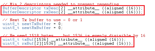

1) Please check if you have correctly aligned Buffer Descriptors and tx/rs buffers? Please see code below:

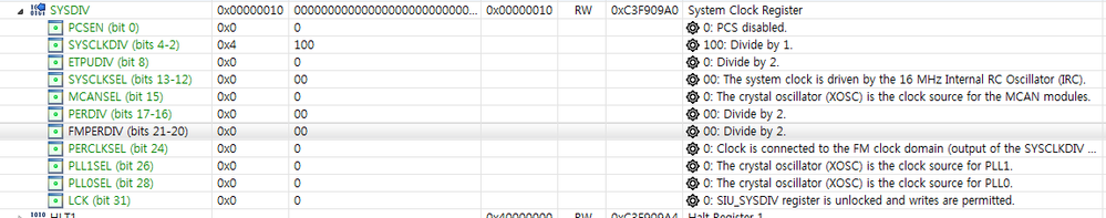

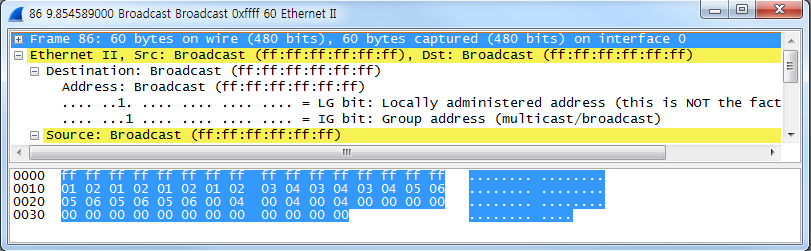

taekyoungkim
I have set SIU.SYSDIVE register like this
So FM_PER_CLK = 8MHz
- SYSCLKSEL : 0 (16MHz IRC)
- SYSCLKDIV : 0x4 (Divide by 1)  -> 16MHz / 1 = 16MHz
- FMPERDIV : 0 (Divide by 2) -> 16MHz / 2 = 8MHz
FEC.MSCR.B.MII_SPEED = 0x2; // 8MHz x ( 1 / ( 2 x 2)) = 2MHz <= 2.5MHz
Is it correct?
Nevertheless, the result of transmitted Ethernet frame was same. (You can still see the duplicated data, 01 02 01 02...)
Please give me a feedback about my clock setting.
Thank you for your patience.
Taekyoung Kim

1) I have same declaration for the Buffer Descriptors.
// Min 2 descriptors needed to prevent resending
BufferDescriptor txDesc[2] __attribute__ ((aligned (16)));
BufferDescriptor rxDesc[2] __attribute__ ((aligned (16)));
// We need 1518 bytes... but 1536 is evenly divisible by 16
uint8_t txBuf[1536] __attribute__ ((aligned (16)));
uint8_t rxBuf[2][1536] __attribute__ ((aligned (16)));
