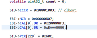

I'm working with MPC5777C in S32DS, I'm trying to interface SRAM (Flow through Burst) using EBI. Here i have initialized all the given EBI registers as per the reference manual. Still EBI is not generating any signals, all EBI pins are in pulled high state. I couldn't able to resolve the issue as there is no reference for EBI interface in S32DS.
Is there any component library or driver file for EBI(MPC5777C), or kindly provide any initialization steps for EBI.
Herewith attached my program.

davidtosenovjan
Hi, at first glance I see an error in your code, writing 2 times to the same register (it should be BR and OR registers). The values it indeed wrong.
Here you may find example code for external SRAM used on MPC5777CEVB (it uses GHS compiler, but all settings you can find in main file):
https://community.nxp.com/t5/MPC5xxx-Knowledge-Base/Example-MPC5777C-External-SRAM-test-GHS714/ta-p/...
Also pay attention to following bullettin, section 5:
https://community.nxp.com/t5/MPC5xxx-Knowledge-Base/External-Bus-Interface-FAQs/ta-p/1124068

Thanks for your reply.
Yes, later I changed the register configuration now I'm able to write in SRAM.
But, when i tried to write in a particular location data is being written in all locations.
And also unable to write data in Muxed 32 or 16 bit.
refer the following attachments.
thanks in advance.

davidtosenovjan
Which is used memory? Your connection? If it is flow through, as you said, you should use zero wait state (commented out in the code)
If you see the same value in all fields, in indicates an issue with addressing.

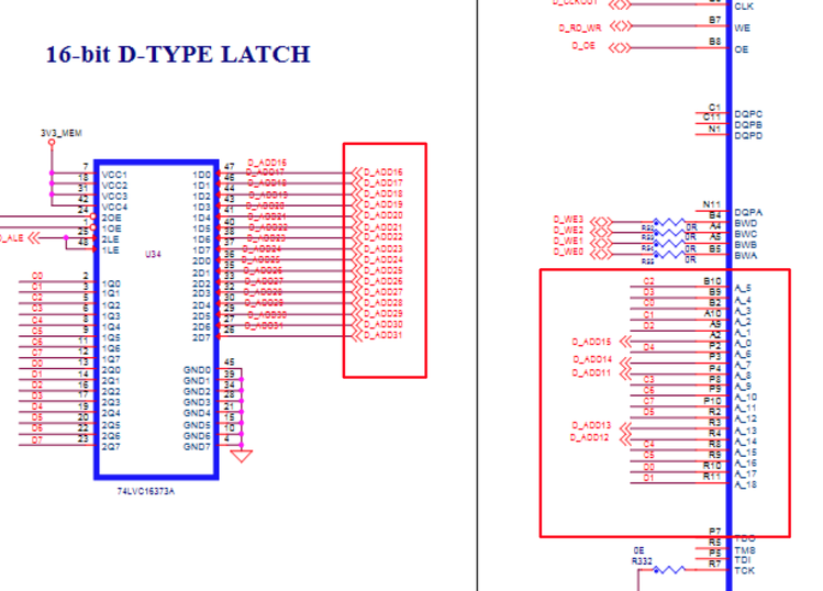

Boopathy_Rangaraj
Memory I'm using is CY7C1471BV33-133BZI (cypress). Hardware connections are  as it is in the uploaded schematic previously.
Yes, the memory is a flow through burst synchronous, also I used zero wait states configuration which is commented in the example program.
For addressing in SRAM there are 2 pins which is A0 and A1 field select and A(address) pins, I tried all the possible combinations, still data is being written in all the fields.
But in Muxed 32 and 16 bit data is not even written in single address. I didn't understand what I'm missing here.

davidtosenovjan
Does this mean you only have connected five address lines? Why there is a latch device there, if unconnected? Please explain

Boopathy_Rangaraj
As per my application I want to use 16 bit or 32 bit muxed mode. So, latch is used and also usage of latch is mentioned in datasheet. My major doubt is whether the connections are fine or else I need to do some changes.
In non mux mode I can able to write data but instead of being written in specific location, it is written in complete CS0 address range locations.
I'm only confused on the address pins connection. We did the connection same as evaluation board (MPC5777c daughter board). The only difference is SRAM which is interfaced CY7C1471BV33-133BZI for more memory.

davidtosenovjan
You haven't answered my question.
On the screenshot it seems on the memory side only address lines A_0, A_7, A_8, A_13, A_14 are connected what's wrong, of course, if it is so.
