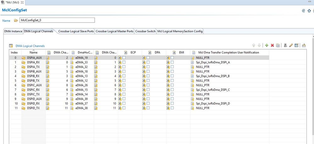

Issue config field: SpiPhyTxDmaChannelAux in SpiPhyUnit tab
I configured 2 DMA channels (eDMA_A channel no. 12 & 13), each one for TFFF & RFDF handling of DSPI_B module, then assigned the Tx & Rx channel to the respective channels in SPI module. But what should be assigned to 'SpiPhyTxDmaChannelAux' field?

The SpiPhyTxDmaChannelAux is a secondary TX DMA channel used for sending internal prepared dataframes to the DSPI PUSH register. Basically you can use any DMA channel to be linked to that channel, here is an example:
Remember, after assigned a DMA channel for TX_AUX, that channel should not be used in any other DMA transfer, e.g. when eDMA_18 is used for TX_AUX DMA channel, it must not be used in any other eSCI or LIN DMA request (as how it's mapped in RM).

Sorry for late reply. TCD is internally configured in MCAL SPI driver. So you don't need to configure it manually. Just make sure that you have called Mcl_Init before Spi Initialization, also I recommend to turn on Development Error Detect feature for easy checking.

My understanding here is TxDmaBuffer will be updated internally also, by configure TCD in Spi_Dspi_InitDma, then DMA will be enabled to start in Spi_Dspi_ChannelTransferDmaInit. DMA_TCDn_SADDR are get filled by calling Mcl_DmaConfigTcd in Spi_Dspi_InitDma.
