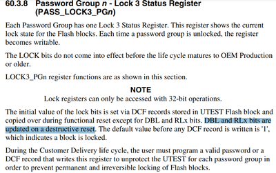

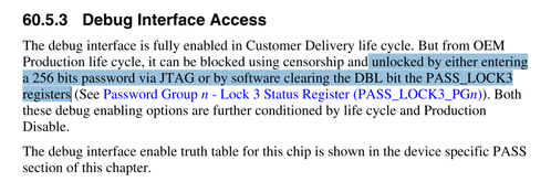

In MPC5775E's Reference Manual, I found that:
According to the description, DBL bit can only be updated after a destructive reset, can I just say that it is impossible to realize the customer's requirement (enable the secure debug feature to protect the JTAG port from being red externally, and the secure debug feature can be enabled and disabled by ActivateSecureDebug() and DeactivateDebug() when the system receives commands from another device with higher priority) on MPC5775E?

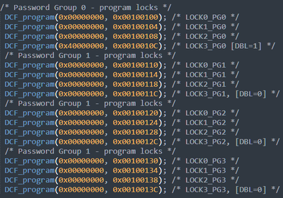

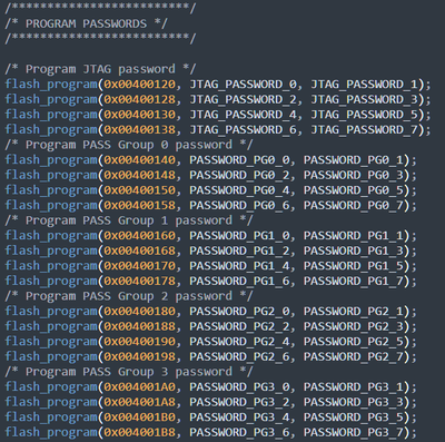

1. Set the JTAG Password and passwords of the Password Groups
2. Set the DBL of LOCK3_PG0 to 1

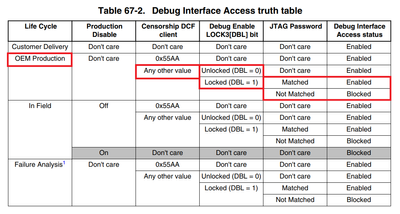

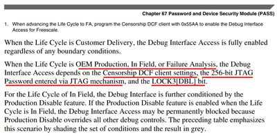

3. If we want to enable debug interface access feature, there are 4 conditions that we need to meet: 1) Life cycle is in or after OEM Production 2) DCF Client - Censorship 3) Set JTAG Password 4) LOCK3_PG0[DBL=1]
WeoWang_2-1672719329023.pngWeoWang_2-1672719329023.pngWeoWang_3-1672719342927.pngWeoWang_3-1672719342927.png
Modify the Censorship DCF client:
4. Modify the Lifecycle:
After this step, the LC in SSCM is OEM Production, and the JTAG is locked, JTAG Password is required if the customer wants to debug with S32DS and Multilink.

6. After step 5, the customer continues to use S32DS and Multilink to connect to the MCU, while, JTAG Password is still required. After entering JTAG Password, the customer finds that LOCK3_PG0[DBL=0].
This is correct according my knowledge. As you changes DBL bit and it will hold this value until next reset (or until you change it) where the DCFs are read and PASS and other modules are set according to DCFs.

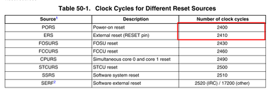

To my understanding, once the DBL of LOCK3_PG0 is clear, the JTAG should be unlocked, while the customer tests the JTAG by debugging another project, JTAG password is still required in the Debug Configuration window. During the debugging, MCU will be reset by Multilink once, I guess this reset is not a destructive reset. If the customer executes a power-on reset, then connects the Multilink to the MCU, it shows that DBL bit of LOCK3_PG0 turns back to 1, which is consistent with the DCF records.

As this is not directly express in the datasheet I will try to summarize it from what I understand.
It is not clear whenever external reset will restart the reset phase from the point where the DCFs are read.
But since this is common for other devices of this family, I expect that connecting the PE which has no hot attach feature like for example Lauterbach, will cause external reset to device.
Since I see the external reset time similar to the POR, I expect that the DBL bit will be set according to DCFs after you connect debugger.
Could you try it with Lauterbach attach feature?
