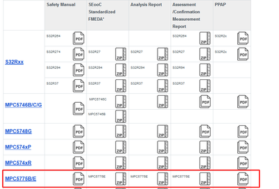

Hi everyone.
Does NXP have a "IEC60730 class B safety library" for MPC5775B?
or any good advice to pass the IEC 60730-1 class B test.
Thanks for any help.
Mark

Hmm, looking at SAF (framework) it supports only S32 devices.
So it is not suitable for MPC5775B which is previous architecture family.
Then only thing available is safety application guide. By following suggested countermeasures you can reach ASIL-D.
Such guide is located at safe assurance community:
https://community.nxp.com/t5/SafeAssure-NDA-group/MCUs-MPUs-available-Functional-Safety-documents-Sa...
there is restricted access and you need to follow attached document in order to get access.
Peter

    As Peter said the automotive standards are more strict, however we just need to prove it, Maybe we can help each other or someone else has passed the test could give us a hint. below are the solution I have check with safety application guide for now.
| Component | Solution
| 1.1 Register |  BIST
| 1.3 Programme counter | Test Function |
| 2. Interrupt handling execution | Test Function |
| 3. Clock | CMU
| 4. Memory |
| 4.1 Invariable memory |BIST
| 4.2 Variable memory | BIST
| 4.3 Addressing | BIST |
| 5. Internal data path |
| 5.1 data |  ERM |
| 5.2 Addressing | ERM |
| 6. External communication | CAN
| 6.3 Timing | Test Function
| 7. Input/output periphery | Test Function
| 7.2 Analog I/O | no used |
| 7.2.1 A/D- and D/A-convertor | Test Function |
| 7.2.2 Analog Multiplexer | no used
| 9. Custom Chips for example : ASIC, GAL, Gate array | no used
I only implement BIST online function for now. Plan to implement other test function or  Safety Mechanism.
question  :
1. How to get the PC counter?
2. Interrupt handle for ERM?
Thanks for any help or suggestion.
Mark

As I have posted earlier the SAF is not supporting SPC5775E/B device.
Peter
