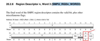

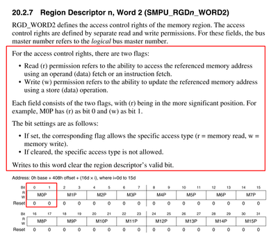

For enabling Data cache, you will need to set SMPU.
1. define range you want to cover by cache in WORD registers.
In SMPU_RGDn_WORD3 you will enable cache for that particular address range:
Define in word 2 type of cache to be enabled:
2. Enable cache in L1CSRx registers.
