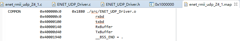

sx
This is my code and it works.
void smpu_config(void)
        // Disable SMPU1 and reconfigure descriptor 0、1、2
        SMPU_1.CES0.B.GVLD = 0;
        // SRAM region 0
        SMPU_1.RGD[0].WORD0.R = 0x40000000; // start address
        SMPU_1.RGD[0].WORD1.R = 0x400000BF; // end address
        SMPU_1.RGD[0].WORD2.FMT0.R = 0xc3ffff00; // rw set for masters: M0, M3, M4, M5, M6, M7, M8, M9, M10, M11, M12, M13
        SMPU_1.RGD[0].WORD5.B.VLD = 1; // enable descriptor[0]
        // SRAM region 1(rxbd、txbd、rxbuffer、txbuffer)
        SMPU_1.RGD[1].WORD0.R = 0x400000C0; // start address
        SMPU_1.RGD[1].WORD1.R = 0x4000193F; // end address
        SMPU_1.RGD[1].WORD2.FMT0.R = 0xc3ffff00; // rw set for masters: M0, M3, M4, M5, M6, M7, M8, M9, M10, M11, M12, M13
        SMPU_1.RGD[1].WORD3.B.CI = 1; // set cache inhibit
        SMPU_1.RGD[1].WORD5.B.VLD = 1; // enable descriptor[0]
        // SRAM region 2
        SMPU_1.RGD[2].WORD0.R = 0x40001940; // start address
        SMPU_1.RGD[2].WORD1.R = 0x400bffff; // end address
        SMPU_1.RGD[2].WORD2.FMT0.R = 0xc3ffff00; // rw set for masters: M0, M3, M4, M5, M6, M7, M8, M9, M10, M11, M12, M13
        SMPU_1.RGD[2].WORD5.B.VLD = 1; // enable descriptor[0]
        // Enable SMPU1 again
        SMPU_1.CES0.B.GVLD = 1;
Get the start address and end address from the .map file
