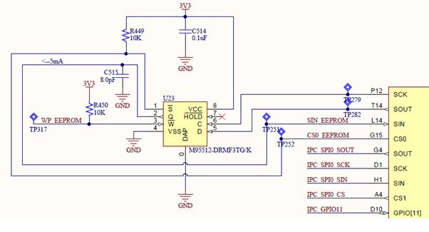

Hi all,
I am Wang Haibin from faladay future company. I have question on use spi to write EEPROM driver.
Now I am develop an spi driver to write EEPROM(M9501M-A125) on chip MPC5748GRM,   MPC5748GRM spi3 is master, EEPROM is slave.
the attachment is the EEPROM M9501M-125 specification
but when I try to write a byte to eeprom, there is no any feedback from the port MISO.
my port configuration is :
void init_spi3_ports(){
  /* Master - SPI_3 to configure to write eeprom */
SIUL2.MSCR[116].B.SSS = 2;                  /* Pad PH4: Source signal is SPI_3 SOUT  */
SIUL2.MSCR[116].B.OBE = 1u;                 /* Pad PH4: OBE=1. */
SIUL2.MSCR[116].B.SRC = 3;      /* Pad PH4: Full strength slew rate */
SIUL2.MSCR[117].B.IBE = 1;                 /* Pad PH5: Enable pad for input SPI_3 SIN */
SIUL2.IMCR[309].B.SSS = 1;    /* Pad PH5: Set as peripheral SPI3, MISO (SIN_3) - 821-512 */
SIUL2.MSCR[118].B.SSS = 2;                  /* Pad PH6: Source signal is SPI_3 SCK  */
SIUL2.MSCR[118].B.OBE = 1u;                 /* Pad PH6: OBE=1. */
SIUL2.MSCR[118].B.SRC = 3;                  /* Pad PH6: Full strength slew rate */
SIUL2.MSCR[119].B.SSS = 4;                  /* Pad PH7: Source signal is SPI_3 CS0_3  */
SIUL2.MSCR[119].B.OBE = 1u;                 /* Pad PH7: OBE=1. */
SIUL2.MSCR[119].B.SRC = 3;                  /* Pad PH7: Full strength slew rate */

1. whether  the enable port rise to high voltage is necessary after send one byte successfully?
2. How to differ the command, address, and data from the data transfer?
3. how to solve the promblem that MISO port is alway no any change, keep in low level voltage?
Do you mind to help me to solve the problem?

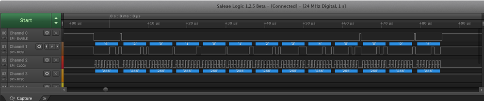

the following diagram show my puzzle:
channel 1 and channel 5 is HOLD and W protect pin in eeprom, already pulll up to battery.
Great thanks!

Your SPI module and pin configuration looks correct. However the command sequence is wrong. Read the EEPROM datasheet carefully, especially chapters 4.3 to 4.6. All commands except of WREN and WRDI require continuous chip selection during all bytes (command+address/data) transmission. You need to use Continuous Selection Format in your SPI master, see chapter 40.5.6.5 of the MPC5748G RM.
The “Q” output of the EEPROM memory is in high impedance state for all write commands and only driven after read command is received into EEPROM and chip select continues to be driven low.
BR, Petr

Thanks for your suggestion, I make some progress in my task of writing EEPROM with spi.
my present work statue as the following:
figure 1
but the datasheet requirement as follows:
figure 2
in order to meet the requirement I have to setting as the chapter 40.5.6.6 Fast Continuous Selection Format discription, that means masking Tasc and Tcsc is needed in my SPI configuration .
but it is likely that I could not understand the masking rules right, I try many cases but cann't reach the figure 2 shows in past 3 days.
I only can setting as the figure 3 shows:
figure 3
That mean write enable byte 6 and data 5 could not be send out via MOSI.
Do you mind help me to correct my fast continues setting?
the follow is my setting:
I think the question should happend on the function Write_Byte(), but I really puzzled the description in chapter 40.5.6.6 Fast Continuous Selection Format.
Besides, I am not sure if the Tasc and Tcsc in register CTAR0 setting would affect the final output?

PetrS
Why there is a need to use a Fast Continuous Selection Format?
Here is a result I got with normal one and modified code. You can test.
I used DSPI3, which is running from 80Mhz, you should recalculate CTAR for your 40Mhz. I set tcsc,tasc, tdt to half of bit rate.
void init_DSPI_3(void)
   DSPI_3.MCR.R = 0x80010001;                /* Configure DSPI as master */
   DSPI_3.MODE.CTAR[0].R =  0x38004445;       /* Configure CTAR0 , baudrate = 1.25MHz */
   DSPI_3.MCR.B.HALT = 0x0;                  /* Exit HALT mode: go from STOPPED to RUNNING state*/
static uint8_t Write_Byte(uint16_t cmd, uint16_t data)
    uint16_t    response    = 0x0000;
    DSPI_3.PUSHR.PUSHR.R = (uint32_t)((uint32_t)(cmd<<16) + data); /**/
    while (DSPI_3.SR.B.RFDF != 1){}  /* Wait for Receive FIFO Drain Flag = 1 */
    response = (uint8_t)DSPI_3.POPR.R;   /* Read data received by master SPI */
    DSPI_3.SR.R = 0x90020000;
    return((uint8_t)((0x02 & response) >> 1));
void EEPROMWriteByte(void)
  #define EEPROM_CMD_WREN 6
  #define EEPROM_CMD_WRDI 4
  #define EEPROM_CMD_WRITE 2
  #define EEPROM_CMD_RDSR 5
  uint8_t write_response,i, DataSize=5;
  write_response = Write_Byte(0x0001,EEPROM_CMD_WREN);
  write_response = Write_Byte(0x8001,EEPROM_CMD_WRITE); /*command write */
  write_response = Write_Byte(0x8001,0); //high address byte/
  write_response = Write_Byte(0x8001,1); //Middle address byte/
  write_response = Write_Byte(0x8001,0); //low address byte/
  for (i = 0; i < (DataSize-1); i++) /* Datasize equal 5, plan to send 1, 2, 3, 4, 5 to EEPROM via MOSI*/
     write_response = Write_Byte(0x8001,i+1);
  write_response = Write_Byte(0x0001,i+1);        // write last data byte
  //read register status EEPROM_CMD_RDSR equal 5
  write_response = Write_Byte(0x8001,EEPROM_CMD_RDSR);
  write_response = Write_Byte(0x0001,0);           // dummy byte to read status
  write_response = Write_Byte(0x0001,EEPROM_CMD_WRDI);
If needed I can test "fast" mode too, but believe this is not needed.
BR, Petr

I have tested the hardware the CS0 is always high.
By writing CS0 high and low but it always high.
Please see the below code and let me know your comments.

Could you please check the hardware schematic also whether it is correct or not.

ramanjineyuluth
Hi Wang,
Thank you very much for your support.
SPI with EEPROM code is working fine now.
The issue is with hardware, we have to connect /HOLD pin to VCC with 10K.
The issue is resolved.

haibinwang
hi,
you code seems work, I could read back the write status change as the follow figure 1:
figure 1
according the EEPROM datasheet define in figure 2
figure 2
status register status be 3, bit1 and bit0 be set 1, illustrate the write process is on going.
and at the next 10ms reread the status register state be 0x00.
but I think the best way to verify the code is to readback the data writen via the function EEPROMWriteByte(void).
but when I try to read the data I write from start address 0b000100, it is failed. show in figure 3
figure 3

PetrS
You need to use continuous chip selection for all bytes to be read.  In your code you are using EOQ bit instead of CONT.
Also from the datasheet ... the instruction is not accepted, and is not executed, if a Write cycle is currently in progress.
So I think you should first read the Status register and if memory is ready, execute read sequence.
It could be done in following way, just generally…
uint8_t EEPROMReadByte(uint32_t Address, uint8_t *pReadData, uint8_t DataSize)
    uint8_t response,i;
    if((response&1)==0) // if memory is ready
                response = Write_Byte(0x8001, EEPROM_CMD_READ);
                response = Write_Byte(0x8001, Hi(Address));
                response = Write_Byte(0x8001, Mid(Address));
                response = Write_Byte(0x8001, Lo(Address));
                for (i = 0; i < (DataSize-1); i++) /* read “DataSize” bytes*/
                    *pReadData++ = Write_Byte(0x8001,0); // dummy byte to read data
                *pReadData = Write_Byte(0x0001,0);     // dummy write for last last data read
                return 0; // read successful
    return 1; // memory is busy still
