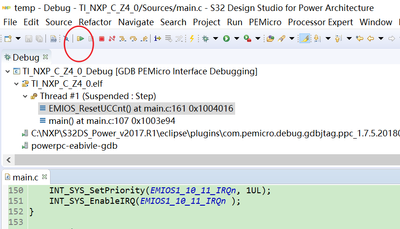

Simple function introduction: Using eMIOS module to generate 2 PWM waveforms with different intial phase(0°,180°). So i wrote a function to change related registers as below:
void EMIOS_ResetUCCnt(void)
eMIOS_MCR_SET_FRZ(INST_EMIOS0_MC,1);
REG_WRITE32(&eMIOS[0]->UC[PWM1_eMIOS_CHN].CNT,0);
REG_WRITE32(&eMIOS[0]->UC[PWM2_eMIOS_CHN].CNT,500);
eMIOS_MCR_SET_FRZ(INST_EMIOS0_MC,0);
Description of the problems encounterred in my project:

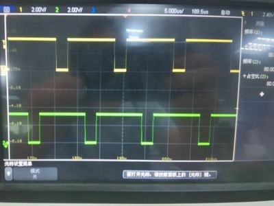

(1) If the above function "EMIOS_ResetUCCnt()" is executed by single-step in debugging mode, the 2 PWM pulses output successfully with different phase. But run it at full-speed without breakpoint, the PWM fail to change their phases.
Figure1. Single-step running
Figure2. Single-step running result (different phases)

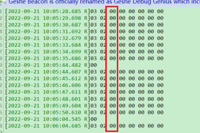

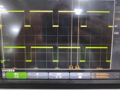

Figure3. full-speed running
Figure4. full-speed running result (same phases)
(2) If preprocessors related to second core(DEBUG_SECONDARY_CORES、TURN_ON_CPU1) is added to the project, and run it at full-speed mode, the PWM output is correct(figure 2).
(3) Base on step (2), the rountine ran successfully in debugging mode, but then stopped debugging mode and restarted the board, the PWM output is wrong(figure 4).

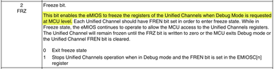

here is the reason:
 The FRZ/FREN take effect only in debug mode:
If you single step over these commands, the device is in debug mode. But if you click on Run button, it's not considered as debug mode.
Lukas

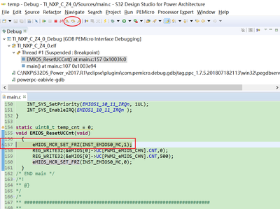

I've made some further tests, found that:
the following 2 instructions must be ran by single-step, or it will fail to modify the corresponding registers.

I‘ve print the DBG_MODE bit of MC_ME->GS register which indicates whether the chip is in debug mode, found that chip was in normal mode while debugging.
