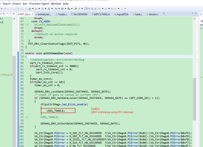

Simple project introduction: Core0 and Core1 are configured in my project, Core0 runs a Safertos system, Core1 runs a simple program without rtos which lights a led in timer interrupt periodically.
The issue is: If safertos program is disabled in Core0, the Core1 operates well(LED blinks periodically).However, if safertos is enabled, the LED of Core1 will stop blinking, it seems like the Core1 is stucked somewhere.

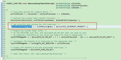

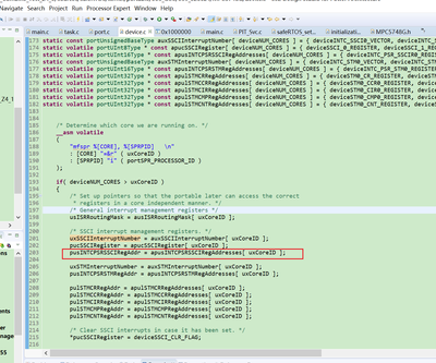

I have done some further test, found that: STM interrupt is configured for Safertos in core0. if i disable the following instruction, other core(core1)can run well.
pusINTCPSRSTMRegAddr is a register addr to configue STM interrupt periority.
So it's no doubt that the issue is caused by interrupt. An interrupt configured in one core will affect other cores.
Could you tell me how to configue interrupt correctly in multicore system?
