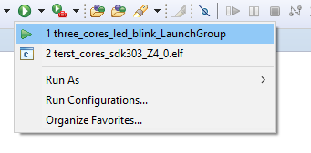

One more detail: I have not been able to flash all three cores onto the board using the 'Flash'  option of the S32DS. It would only write to the first core. The way I program all three cores of the board is:
1. creating a 'launch group' with all the cores.
2. clicking 'run configuration' and selecting the launch group with three cores.
3. Unplugging the device - the program now resides in the flash.
