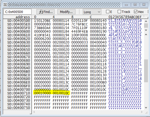

After I have made the reading protection of UTEST, I encountered the following problems:
1. The chip is in reset state, after the restart (whether or not JTAG is connected).
2. I can view the data form UTEST by using the lauderbach after enter the Password of  JTAG and select the function of        'Halt core at power-on reset', but I cannot write new data( Unlock utest flash read protection) to UTEST flash.
UTEST flash DCF records:
issue:
1. Why I didn`t set the LOCK3[DBL] bit, but I had to enter the password of JTAG to halt the chip when enabled the UTEST Flash for read?
2. Why cannot rewrite the data on UTEST?

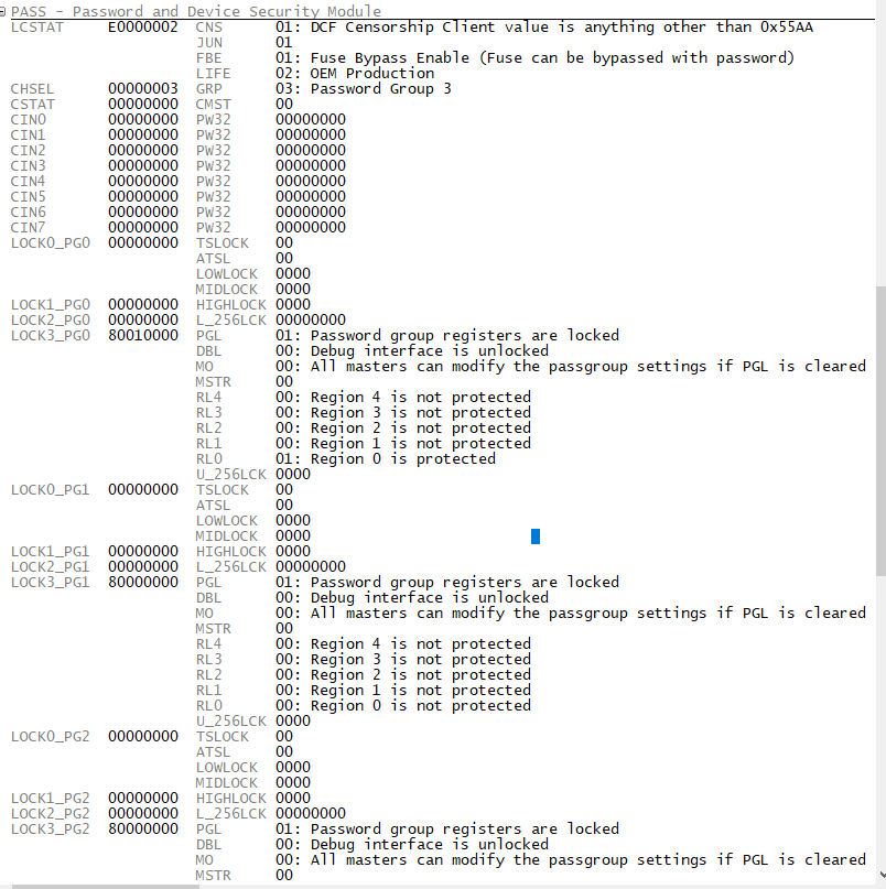

Below is PASS register status:(All flash blocks are readable and writable)

Yes, I have configured the PASS module Read lock and enabled JTAG censorship by programming the PASS DCF records.

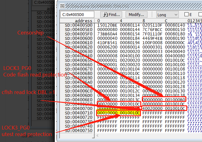

Below is my configuration setps for PASS module to enable flash read protection:
1.Program JTAG Password and PASS Group0-3 Passwords.
2.Program PASS DCF records to set PASS Group 0-3 lock status ( In order to prevent permanent and irreversible locking of Flash blocks, setting for all lock bits is ‘0’.)
3.Program Censorship DCF records(if Censorship DCF client (data) != 0x55AA then MCU is in ‘censored’ mode
4.Advance Life Cycle from Customer Delivery to OEM Production
5. Program utest read protection
After rebooting, the chip died.
By the way, I didn`t have this problem when I tested code flash read protection.
Frank
